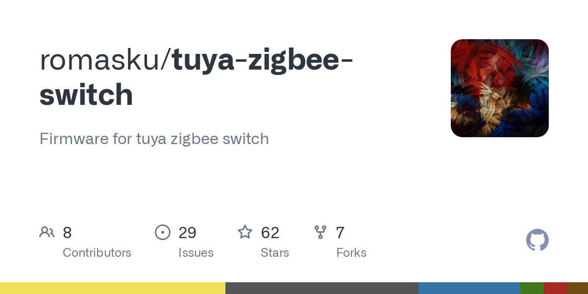

Here is an amazing project with custom firmware for Tuya switches that can be flashed OTA:
