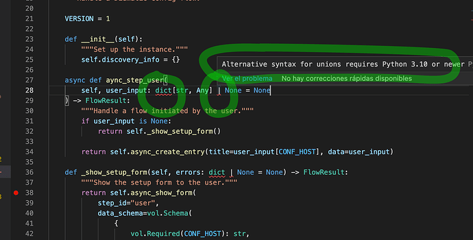

I notice that the syntax of the conflig_flow.py example contains parameters like:
    async def async_step_user(
        self, user_input: dict[str, Any] | None = None
    ) -> FlowResult:
but when I copy exactly the same code into my own config_flow.py the compiler raises syntax errors related with python version 3.9 not supporting that.

In two places:
While editing code:
And while executing it:
In the same line numbers
