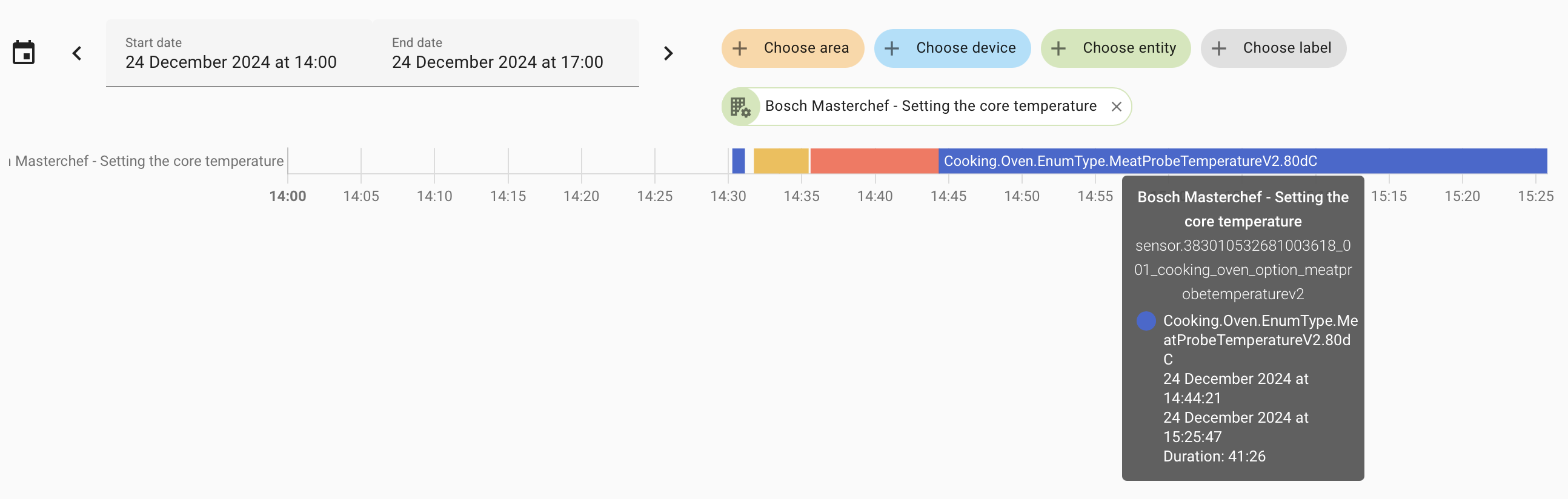

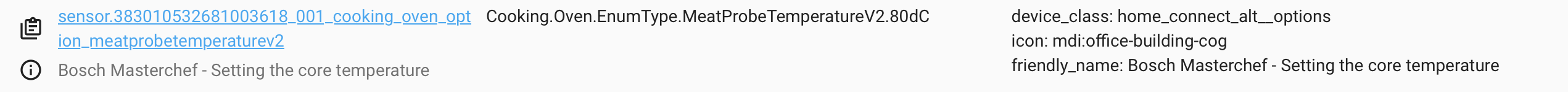

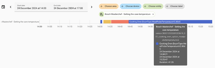

Is temperature probe supported? I have a bosch oven with builtin temp. probe. Home Connect app shows the probe temp (if connected) and allows programs with it (cook until internal temp. 80C, etc).
I can see the target temp although it looks silly because it is not numerical (80C in this case):
History:
I cannot seem to find current probe temp anywhere.
Merry Christmas!
Yeah… Bosh seems to like using a lot of characters of no use.
You need to make a template sensor to get the numeric value.
{{ (states('sensor.something') | regex_findall("(\d+)dc"))[0] |int }}
My main issue is that there is no current probe temp. Just target. Type casting is a minor issue.

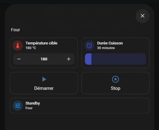

Bonjour / Hi,
Je voulais vous partager l’intégration de mon four Siemens avec Home Connect Alt.
I wanted to share with you the integration of my Siemens oven with Home Connect Alt.
  1. scripts pour Allumer le four avec en variable : la température et la durée. Le programme est toujours le même. Scripts to turn on the oven with the following variables: temperature and duration. The program is always the same.
sequence:
  - action: home_connect_alt.select_program
      validate: false
      device_id: 7a7ecff00f38ed592a454f64186cb248
      program_key: Cooking.Oven.Program.HeatingMode.HotAir
  - action: home_connect_alt.start_program
      validate: false
      options:
        - key: Cooking.Oven.Option.SetpointTemperature
          value: "{{ states('input_number.consigne_temp_four') }}"
        - key: BSH.Common.Option.Duration
          value: "{{ (states('input_number.consigne_duree_four')|float(0)) * 60 }}"
  - action: input_number.set_value
    metadata: {}
      value: 180
      entity_id: input_number.consigne_temp_four
    metadata: {}
      value: 30
      entity_id: input_number.consigne_duree_four
alias: Demarrer_Program_Four
description: ""
fields: {}
Le script pour éteindre / The script to turn off :
sequence:
  - device_id: 7a7ecff00f38ed592a454f64186cb248
    domain: button
    entity_id: 8c5dd983cfc66649e7083b1bfa2b5c87
    type: press
alias: Arreter_Program_Four
description: ""
  1. dashboard : on peut modifier la température et la durée (j’utilise 2 input_number) / you can change the temperature and duration (I use 2 input_number)
- type: vertical-stack
  cards:
    - type: custom:bubble-card
      card_type: pop-up
      hash: '#four'
    - type: heading
      heading: Four
    - type: horizontal-stack
      cards:
        - type: custom:mushroom-number-card
          entity: input_number.consigne_temp_four
          icon_color: red
          fill_container: false
          display_mode: buttons
          entity: input_number.consigne_duree_four
          icon_color: indigo
          display_mode: slider
      cards:
        - show_name: true
          show_icon: true
          type: button
          entity: script.demarrer_program_four
          icon: mdi:play
          icon_height: 30px
          show_state: false
          tap_action:
            action: toggle
        - show_name: true
          show_icon: true
          type: button
          entity: script.arreter_program_four
          icon: mdi:stop-circle-outline
          icon_height: 30px
          tap_action:
            action: toggle
    - type: custom:mushroom-entity-card
      entity: >-
        sensor.siemens_hb578a0s6_68a40eaa8213_001_bsh_common_setting_powerstate
      primary_info: state
      secondary_info: name
