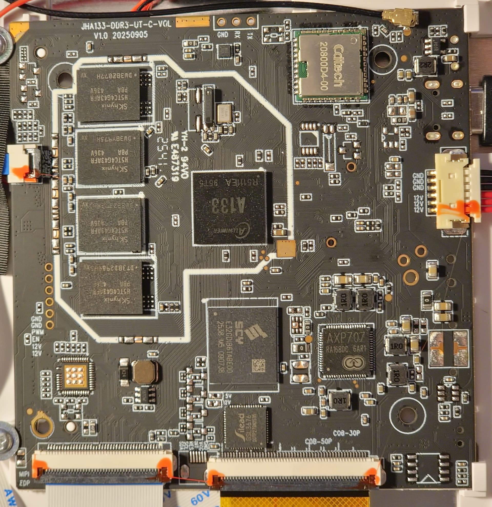

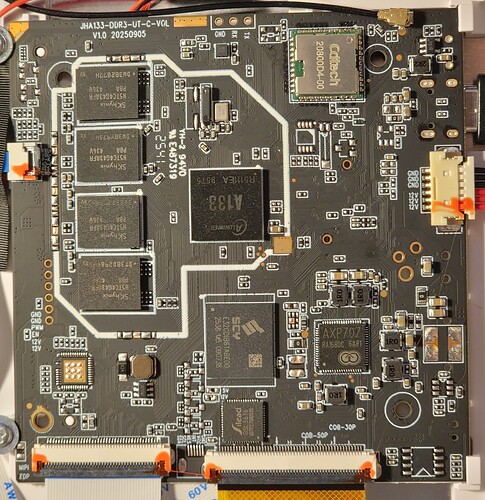

2GB RAM, 32GB storage, Allwinner A133 SoC, there’s a USB C port inside that can be used for power or data, or you can use the included 5v2a DC adapter. The processor is decent enough to decode video from my doorbell without freaking out and can navigate dashboards and other webpages smoothly. There’s even UART pins on the board if you really mess things up like I did by locking myself out with Fully Kiosk Browser.

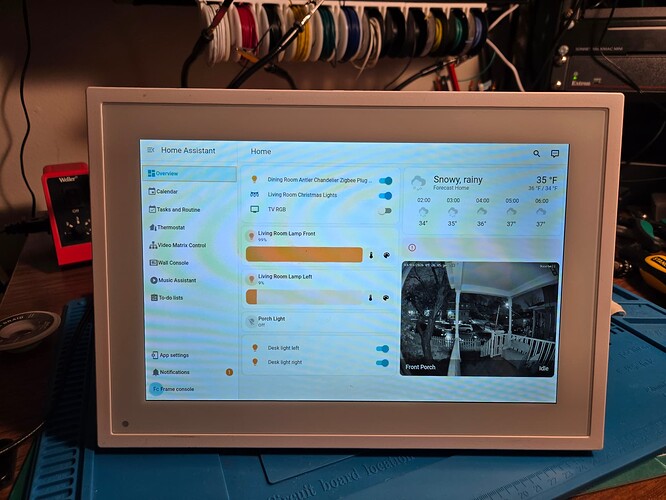

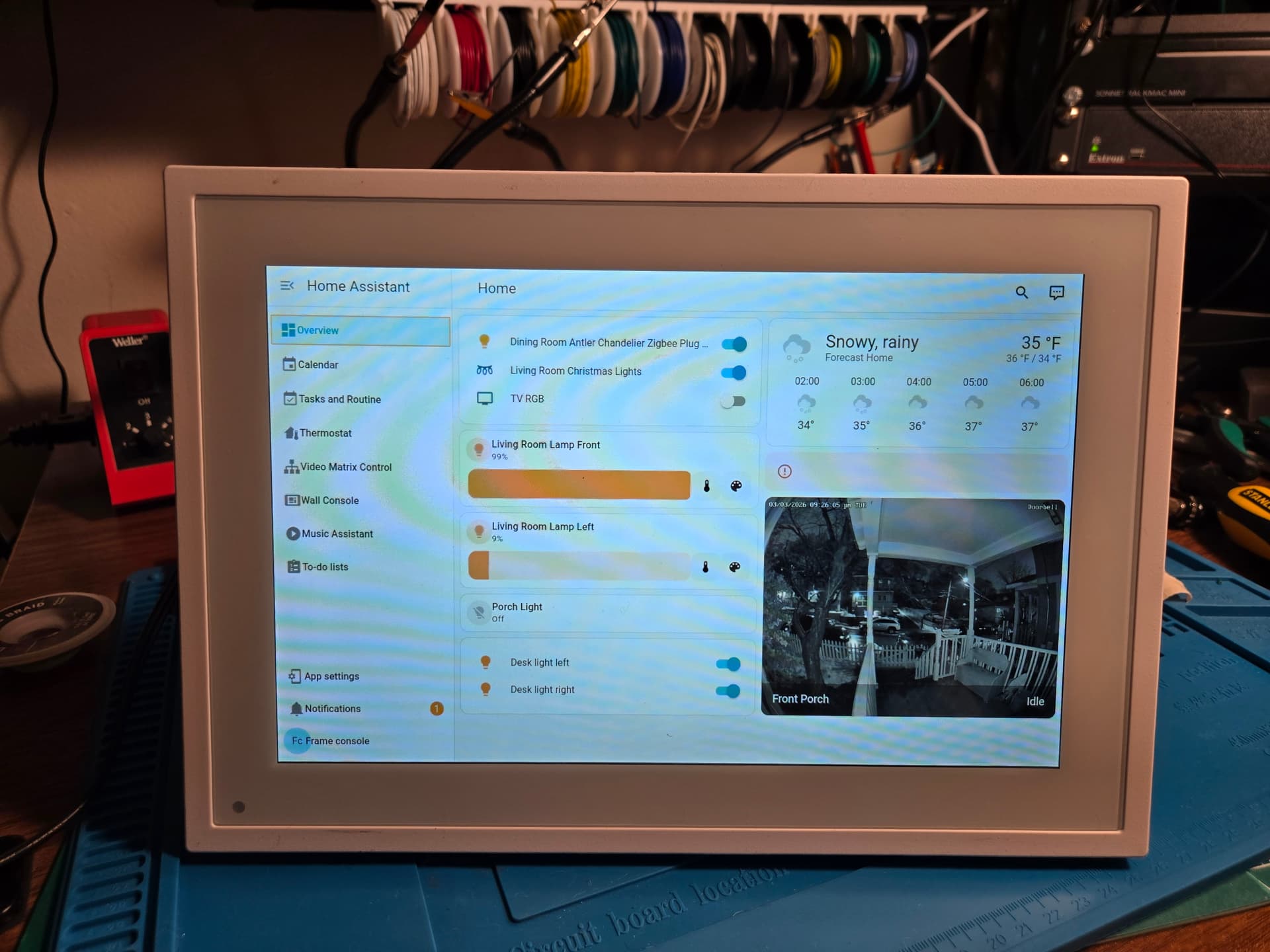

Onto Fully Kiosk Browser. I can’t get it to function reliably without locking myself out of ADB. I think it’s due to the custom android build and how it presents a work profile. Thankfully the Home Assistant Companion app works just fine and can be made to start on launch by adding:
exec u:r:shell:s0 – /system/bin/sh -c “sleep 15 && am start -n io.homeassistant.companion.android/.launch.LaunchActivity”
to
/vendor/etc/init/hw/init.device.rc
via ADB.
