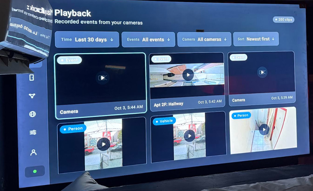

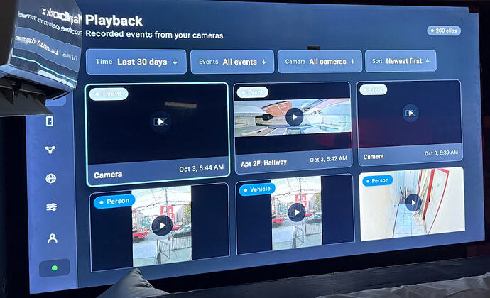

UniFi has a pretty extensive API, and with all the improvements released this year, it’s become possible for me to develop an app for Android-based TVs that lets you view and interact with your UniFi system directly from your TV.
I’m keeping the main controls fairly simple for now, focusing on live camera feeds and playback of previous recordings. But here’s where it gets interesting: the app can display a live picture-in-picture popup over whatever you’re watching, showing the camera’s live stream along with custom controls.
One of those controls lets you send preconfigured text-to-speech (TTS) messages directly through cameras with built-in speakers. That’s another advantage of using UniFi cameras, since supported models can also be exposed as media players through the Home Assistant UniFi Protect integration. (Essentially any unifi camera with a speaker is a media player in home asssitant even door bells)
You can also customize which cameras and detection events trigger these popups, so you’re not constantly interrupted by every little movement. I will be adding loittering as a detection type too if users prefer that over simple person,pet,vehicle, motion.
It’s still a work in progress, but it’s coming together pretty nicely!
