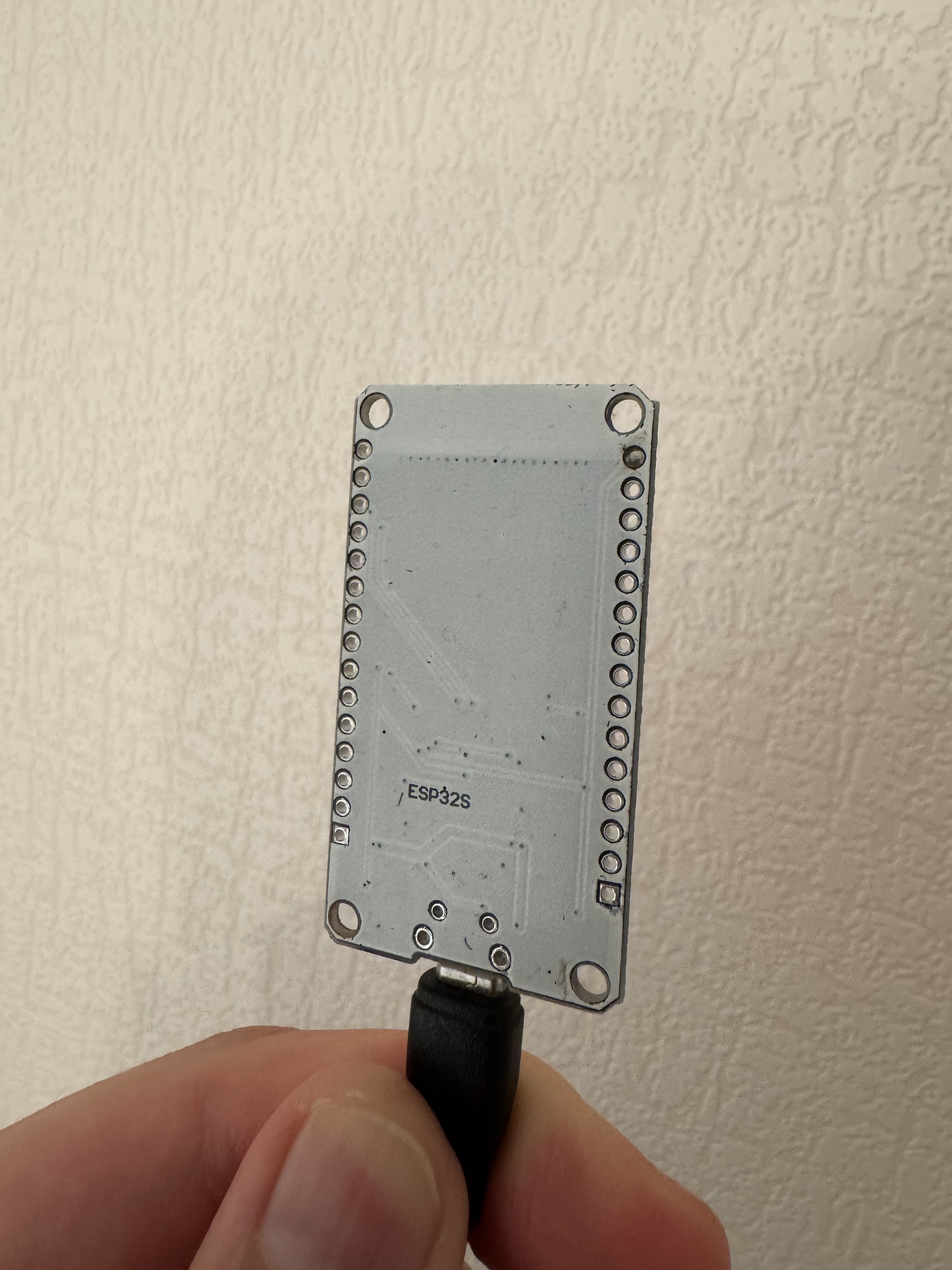

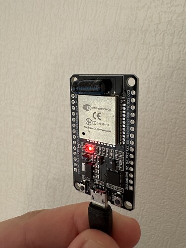

Hello. I’ve just started playing around with Home Assistant and so far I’ve managed to integrate all the devices in my home except for the AM43, which I bought a few years ago. I’ve read the entire thread, but I have one question, the most important one so far: What type of ESP32? I definitely see that the ESP32-WROOM-32UE connects to the AM43. Could you tell me which modules you’re using that can connect to the AM43?
Best regards.
here is mine
And the latest revision am43_esphome_ha/am43.yaml at 1c053e8ec75d29f4255e7f71b38e1a3ff4f813ec · akrigator/am43_esphome_ha · GitHub
I bought the ESP32-WROOM-32UE because a friend wrote that he was able to connect to an AM43 using this module. I should have it home tomorrow and will start configuring it. If I run into any problems, I’ll ask for your help.

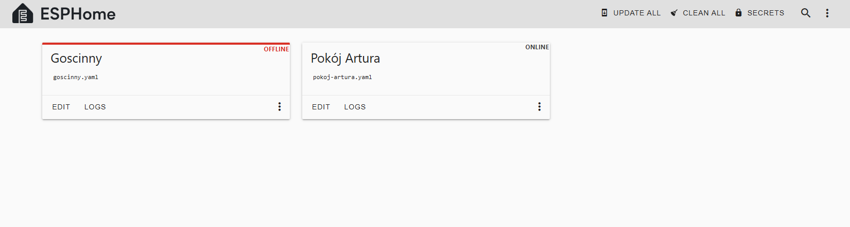

Unfortunately, I have a problem. I have three devices, each in a different room of the house, facing different directions, so I had to control each separately. I modified your am43.yaml file to control only one blind motor. And if I add one in ESPHome, everything works perfectly! But when I modify the file for the second blind motor, I validate it, and everything is fine. However, when I install it, it can’t connect and is offline.
The log at the end of the installation contains this entry:
<============================ [SUCCESS] Took 14.52 seconds ===============================
INFO Successfully compiled program.
ERROR Error resolving IP address of [‘gospital.local’]. Is it connected to WiFi?
ERROR (If this error persists, please set a static IP address: WiFi Component - ESPHome - Smart Home Made Simple)
ERROR Timeout resolving IP address: Timeout while resolving IP address for [‘goscinny.local’]
WARNING Failed to upload to [‘goscinny.local’]>
There’s a problem connecting to your device, but I don’t know what’s causing it.
As i understand you are trying to flash he second esp via wireless option, have you try with wired option?

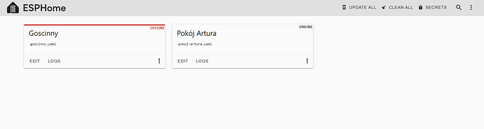

Yes, and that’s when the previous configuration is disconnected. Just like in the screenshot above. I’m trying to find a way to make these configurations work simultaneously. Some YouTube channels claim it’s possible, but no one has shown how. Perhaps I’m making a small mistake. In one of the materials the author said that a new upload deletes the entire previous one.
