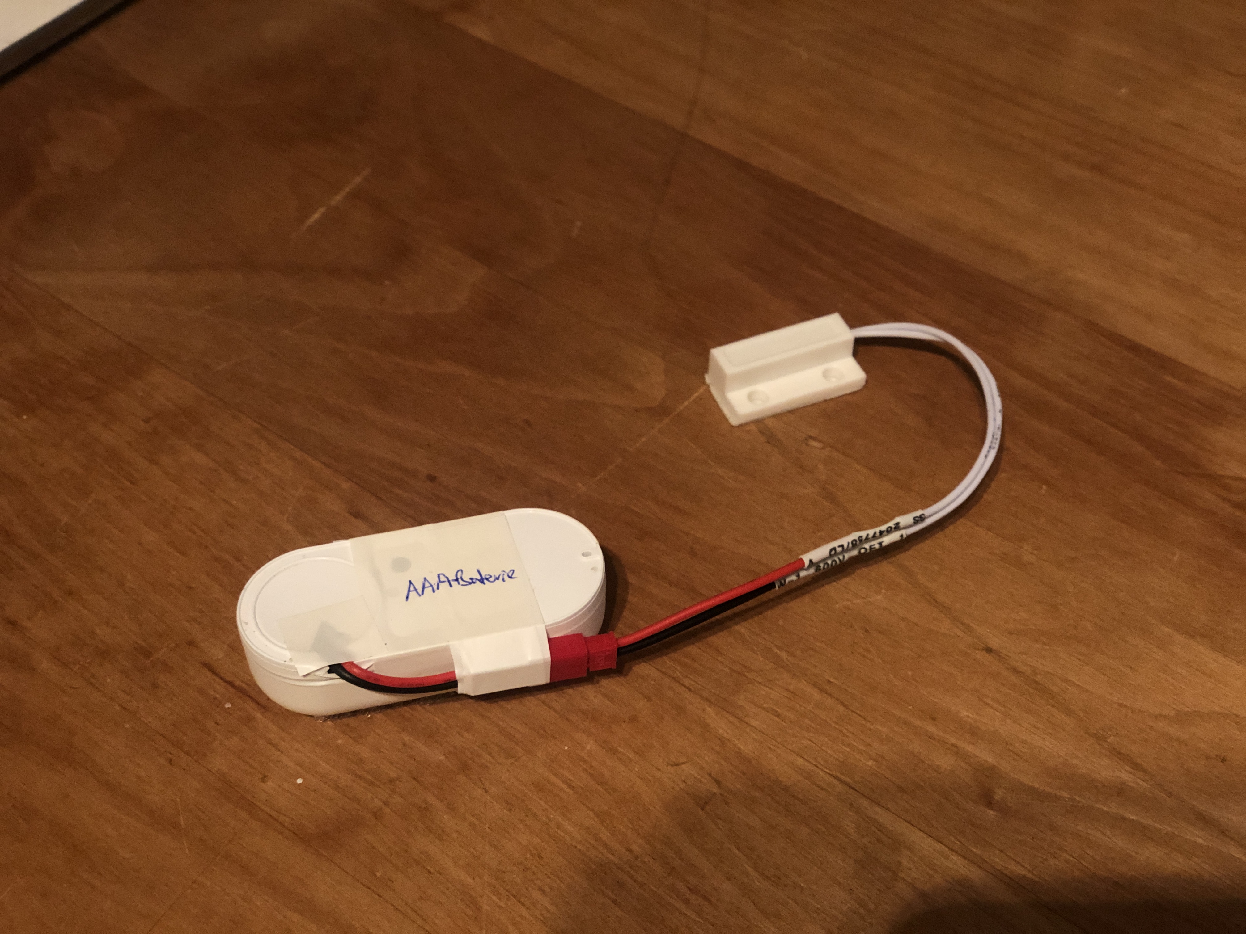

I had the idea to use an amazon dash button to track my mailbox (hassio addon Dasshio). So I opened it and soldered a reed contact (magnetic sensor) to the button solderpads.
Unfortunately I had not thought about the reset function of the dash button. If you press it (= magnetic contact) for 6 seconds it will reset and lose its wifi configuration.

I’d need something that reads the sensor and than sends a short trigger (not 6 seconds^^) to the dash button. I would be able to to this with an arduino, but this would need another power source. Is there a way to to this with a circuit (soldering would’t be the problem)?
