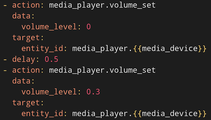

I actually found this thread whilst looking for a slightly different issue - trying to mute the echo / switch input / disable audio before or after issuing a command to stop hearing the spoken response from running skills like “Playing progressive house”, but it just forces the volume back to 1 even from mute.
ANYWAY thought whilst here I’d offer my input on this issue - I have for many years now successfully (and still currently) masked out the volume increment 'bong’s by simply setting the volume to 0 first - the next change is always silent.
That’s not even a HASS thing either, it works the same way if you say to Alexa directly “volume zero” then “volume three” - silence.
As mentioned here already through you do need to have a 500ms delay between the media_player.volume_set commands in HASS otherwise it does it so quickly it trips itself up.
Anyway hope this helps someone. :slight_smile:
