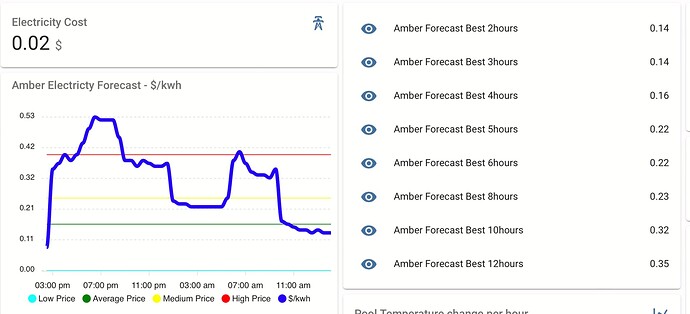

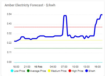

A bit nicer looking, price only and some bands
Screenshot 2022-02-15 172128
type: custom:apexcharts-card
graph_span: 24h
span:
  start: minute
header:
  show: true
  title: Amber Electricty Forecast - $/kwh
  show_states: false
  colorize_states: true
series:
  - entity: sensor.amberelectricity_general_forecast
    float_precision: 2
    color: cyan
    stroke_width: 1
    show:
      legend_value: false
    data_generator: |
      return entity.attributes.forecasts.map((entry) => {
        return [new Date(entry.start_time), 0];
    float_precision: 2
    color: green
    stroke_width: 1
    show:
      legend_value: false
    data_generator: |
        return [new Date(entry.start_time), 0.16];
    float_precision: 2
    color: yellow
    stroke_width: 1
    show:
      legend_value: false
    data_generator: |
        return [new Date(entry.start_time), 0.25];
    float_precision: 2
    color: red
    stroke_width: 1
    show:
      legend_value: false
    data_generator: |
        return [new Date(entry.start_time), 0.4];
    float_precision: 2
    color: blue
    show:
      legend_value: false
    data_generator: |
        return [new Date(entry.start_time), entry.per_kwh];
yaxis:
  - min: 0
    max: ~0.40
    decimals: 2
    apex_config:
      forceNiceScale: true
@markpurcell has come up with a great way to identify the trigger or condition value for “Best X number of hours” in the next 24hours.
Gives the KW/hr rate likely to give you X hours based on current forecast (obviously changes)
I’m using this to run my pool heatpump heater in the best hours of the day and will probably automate the circulation pump and chlorinator. Try and get it to wait till best period, and also not have to seasonally adjust a static value.
I’ve set up a heap for different run times
-sensor
      amber_daily_forecast_best4hr:
        friendly_name: "Amber Forecast Best 2hours"
        value_template:   >-
          {{ (state_attr('sensor.amber_general_forecast', 'forecasts') | map(attribute='per_kwh')|list|sort).4}}
  - binary_sensor:
      - name: "Amber Cheapest 2 Hours Trigger"
        state: "{{ states('sensor.durst_home_general_price')|float(0) <= (state_attr('sensor.durst_home_general_forecast', 'forecasts') | map(attribute='per_kwh')|list|sort).4}}"

I have a price spike coming up this afternoon, which really distorts the graph.
Mark, the ~ in front of the 0.5 set the scale to 0.5max unless it goes above this figure. If you remove the ~ it will have a fixed scale and the peak will just be above the display area.
Some pretty wild price swings - the wholesale pricing max is particularly volatile
