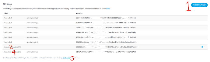

Got it to work. Someone posted somewhere that you have to first create an API Key (1), give it a Label (2), then at the bottom go ahead and click the link to generate an Application Key (3). That actually shows up as a new API Key, but with (application key) after the label (that you should label (4) the same as the previous line/label so you have that pair…
