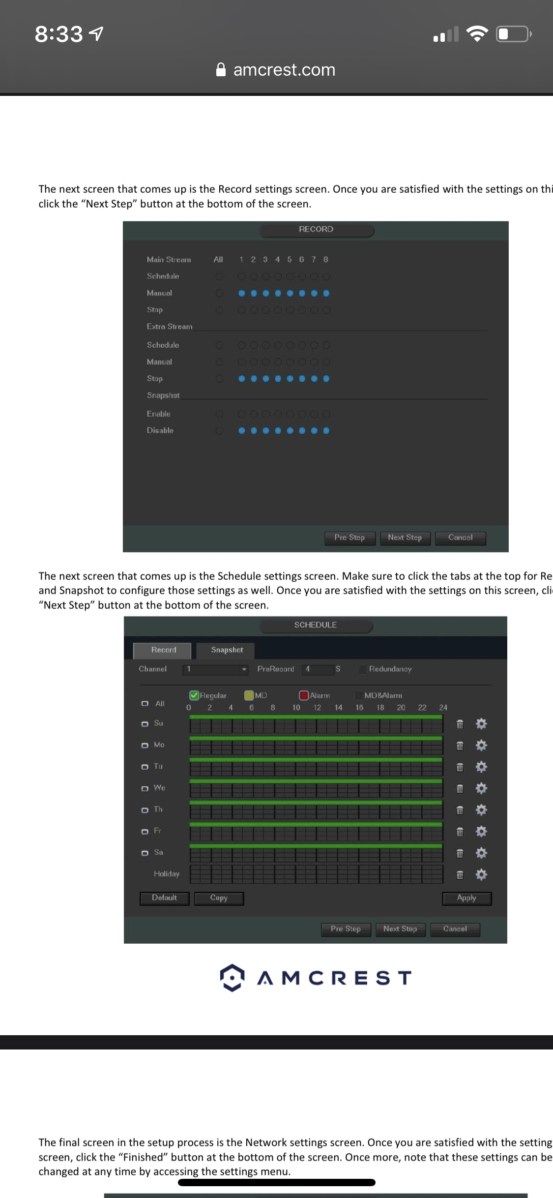

Try changing the subtype to 1… slightly lower quality… I had the same issue at one time… I can switch to high quality now without the issue but I also have turned off snapshots all together… I think it was just too much processing for my nvr or something
"Turned off snapshots… " expand on that, if you would. I don’t have snapshots turned on anywhere that I know of. Meanwhile, I’ll try the other sub-stream on half of the cams and see if that helps.
I don’t know what model you have but should be somewhat close… the snapshots never worked for me… they looked like your example even in a direct email from the nvr… also mentioned a lot on amcrest forums… I don’t know if resolved with newer firmware or anything though…
This feature has it save still images either all the time or when motion detected depending on how you have it set… just ate up video space for me so turning it off let me save a few more days of video
Aha. Yeah I’ve never used that snapshot feature and the lower res cams now seem to work better.
