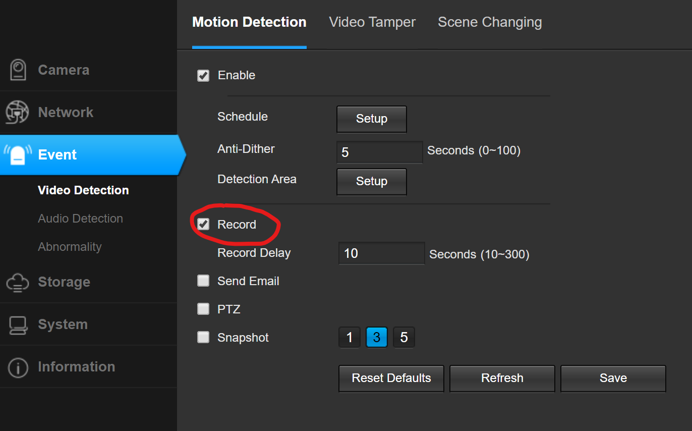

I’m trying to setup my IP4M-1051 but amcrest.disable_motion_recording/amcrest.enable_motion_recording doesn’t seem to do anything.
When I have this:
camera is recording video on motion regardless of motion_recording value. And if I uncheck Record, it’s not recording anything regardless of motion_recording value.
The sensor works so I guess I can manually trigger amcrest.disable_recording/amcrest.enable_recording in an automation but I’d rather not.
