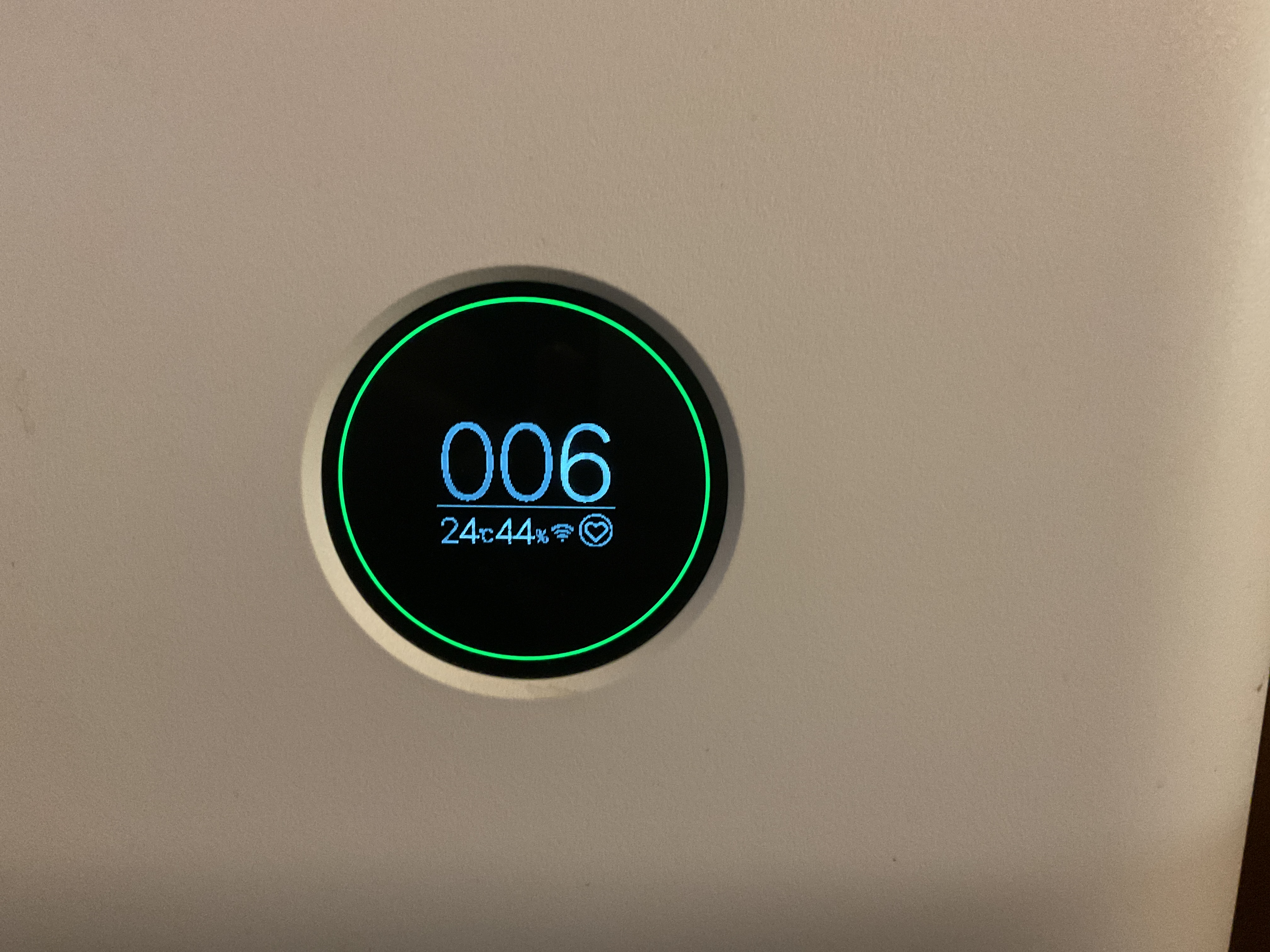

Ok, if you’re planning to use them in the room where you sleep ok, otherwise be aware that oled’s are very prone to burn-in. In the picture is example of my air purifier appr 2-3 years old - note that zeroes are not as bright as 6, also 6 has stripes / shadows across.
If you’re gonna use them make sure that you’re gonna set them (pretty) dark, or even turn them on only at request.
