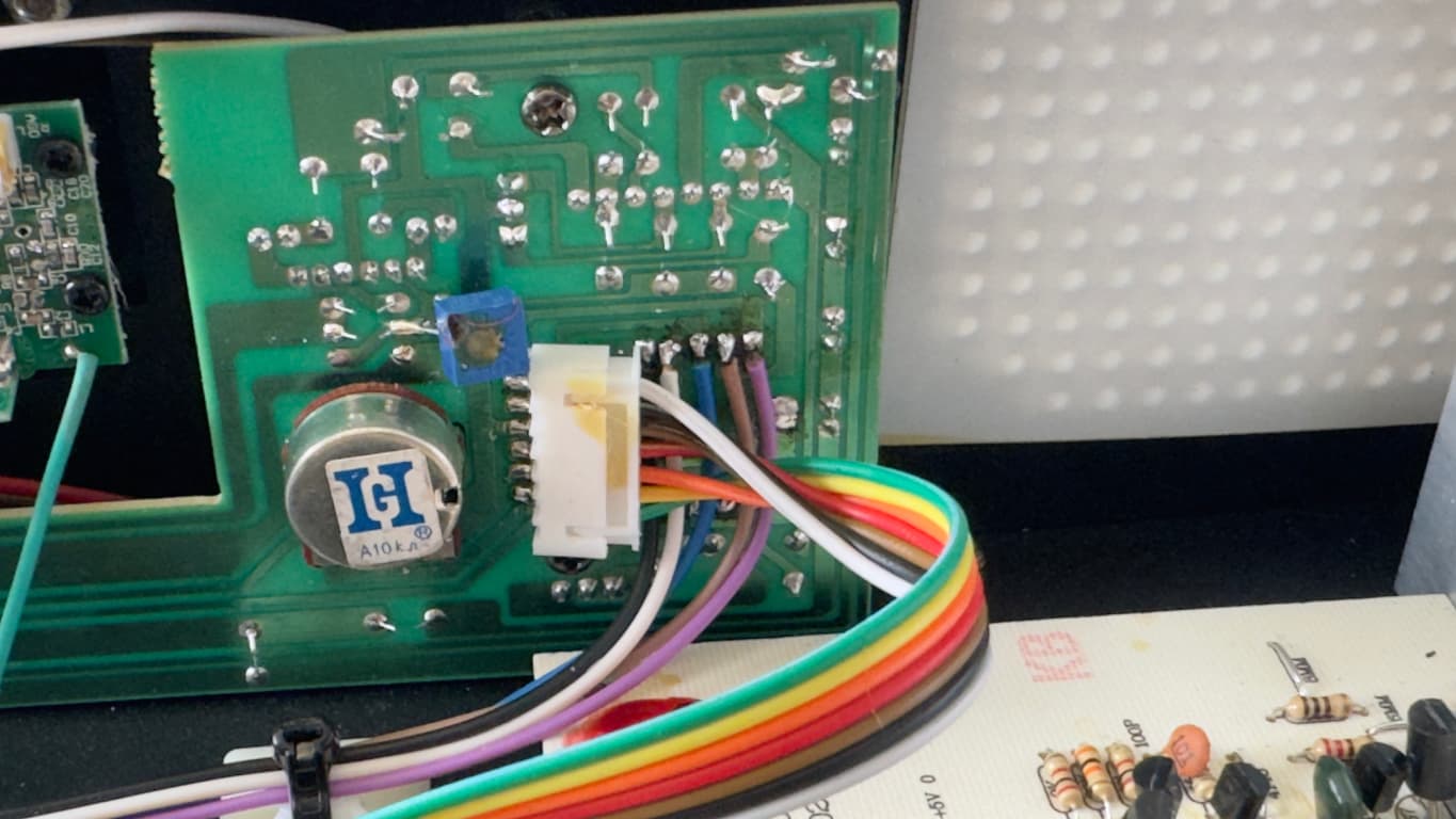

I would plan to wire into the rotary dial where the input select is. Is it safe to assume that each input is just a short to GND to trigger? Anyone have experience with this or done anything similar?

No, but it’s relatively safe to verify it with multimeter.

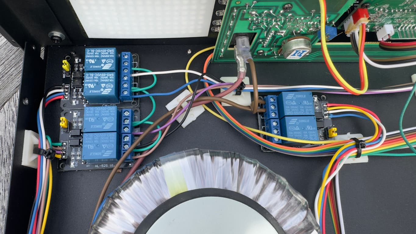

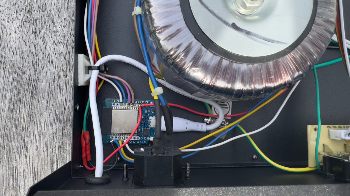

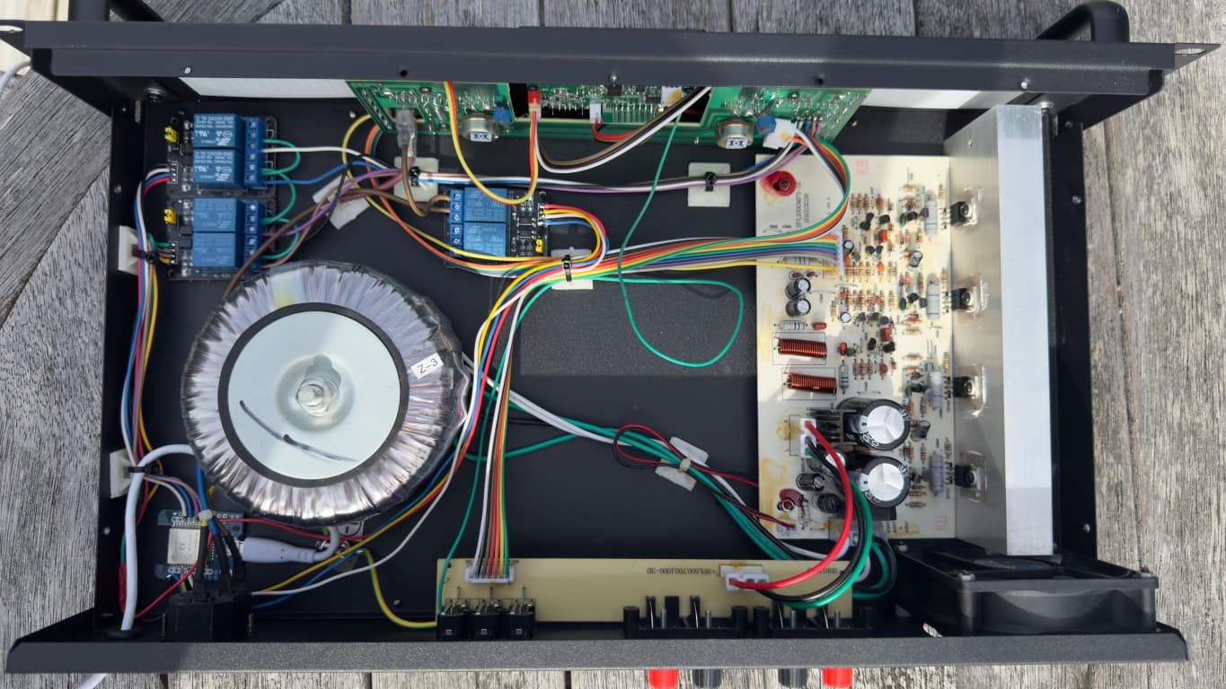

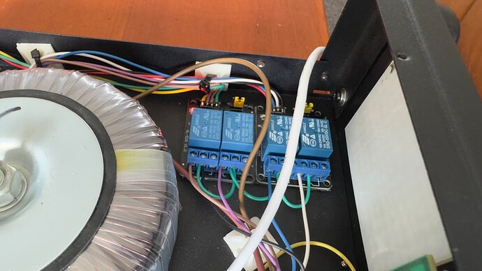

I got this done, using esp32 and esphome I am now able to switch channels and power.
One thing I want to do now is add a custom media control card that can control each entity individually, such as a input select card that can select and input and I can define the entity for each input.
Possibly a dropdown but I am not sure how I can select each entity to trigger when the dropdown option is selected.

This doesn’t appear to be the same device as in your first post. But it would be preferable to show us what you actually did. Ie code, wiring diagram.

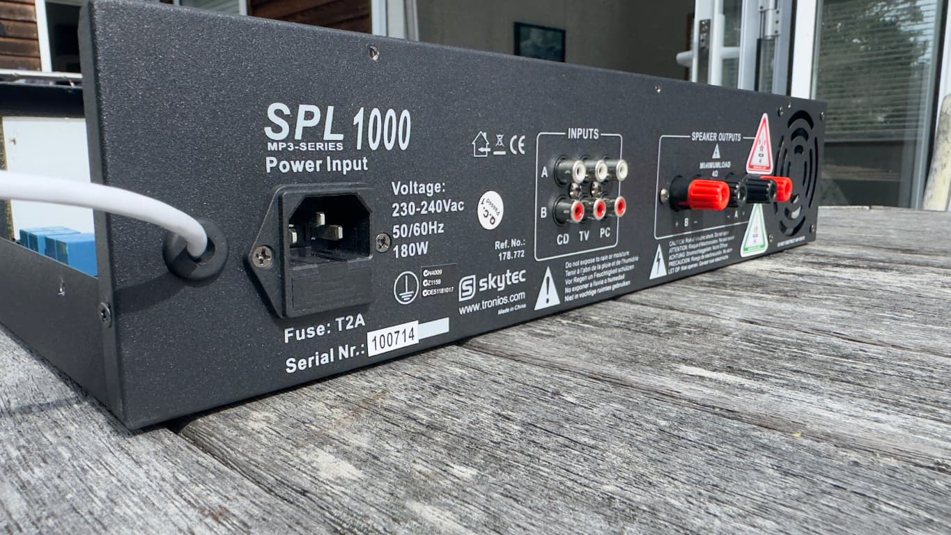

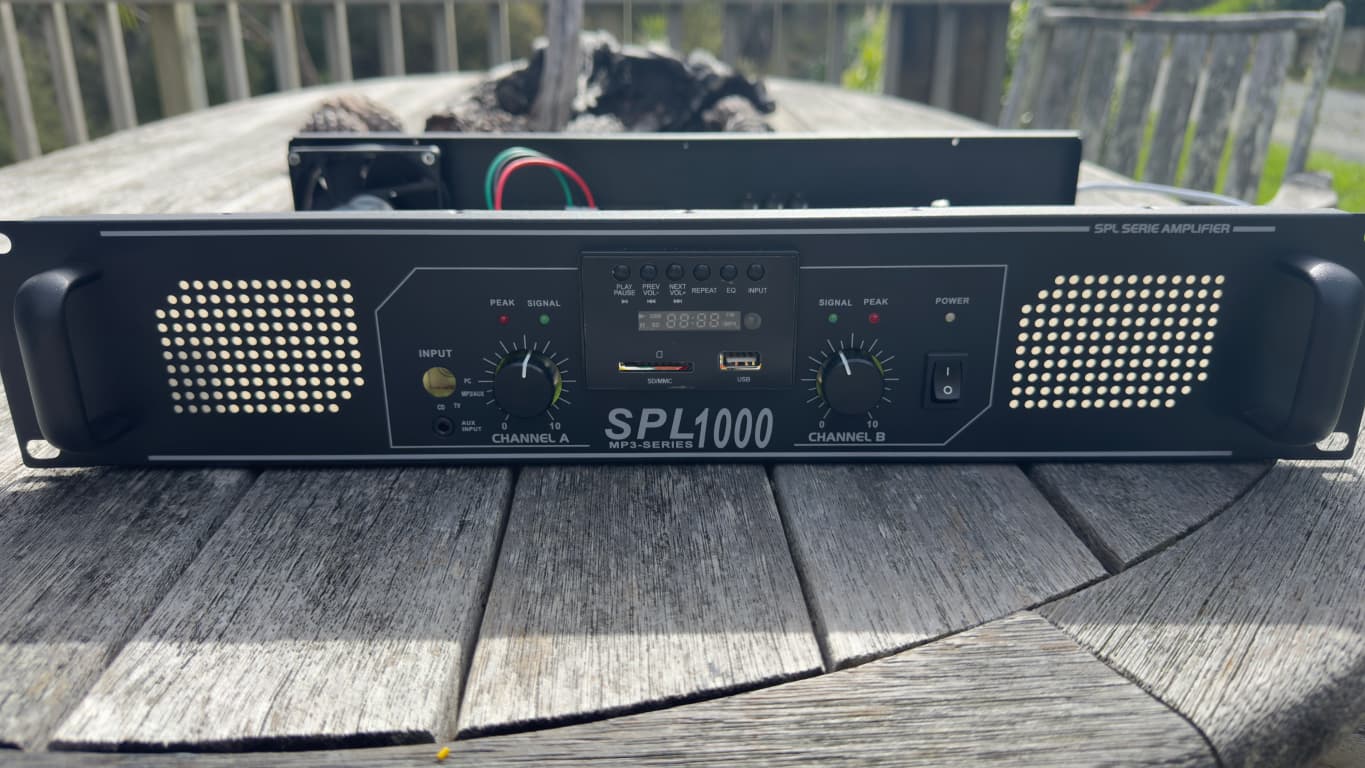

Yea turns out the previous one was a Media Player only and not an AMP, when in reality I needed the opposite.
Here is my config, I will do a wring diagram later.
