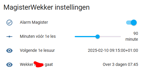

I still have one thing that doesn’t work: I have now set the ‘Magister alarm clock’ to run 90 minutes before the first lesson starts. However, when I adjust that value, it does not seem to carry over into automation. I have created a dashboard card in which I read and set a number of settings:
2025-02-07 14_36_27-Tablet – Home Assistant
The slider refers to entity “input_number.alarm_magister_offset” following @Emphyrio 's instructions.
The automation is as follows:

EDIT: After writing this post, I noticed the probable error myself… I followed the instructions literally but I now notice the helper is named “input_number.alarm_magister_offset” where the entity in the template sensor and the automation is “input_number.magister_offset”. How could I not have seen that before I don’t know…
Thanks @ChielB, I fixed it in the starting post. For the people trying this after us :wink:

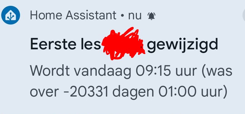

I’ll give it a try on my own phone prior to notifying my son’s phone and report back about the experience. Thanks for your efforts!
There are too many false triggers with this first version of the automation. I am tuning things, will get back with an updated version.
@ChielB The automation was updated (two posts up). We tested it this week and removed the false / irrelevant triggers.
Apparently, the iCal sensor regularly fails to update and temporarily gets a state ‘unknown’ or ‘unavailable’. This caused irrelevant notifications and was fixed in the automation.
Have fun with it :slight_smile:

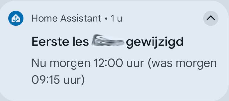

The funny thing is: prior to updating the automation, I notice the automation sends a notification at 12.00, when the “next lesson” is changed from today to tomorrow.

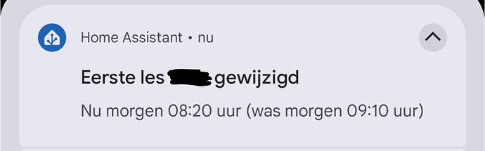

The first unsimulated/natural change in schedule came in yesterday evening:
Now even my adolescent son suddenly recognised the benefit of using Home Assistant :stuck_out_tongue_winking_eye:

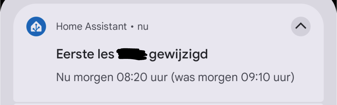

Notification just popped up :white_check_mark:
yep indeed it’s working now! :wink:
