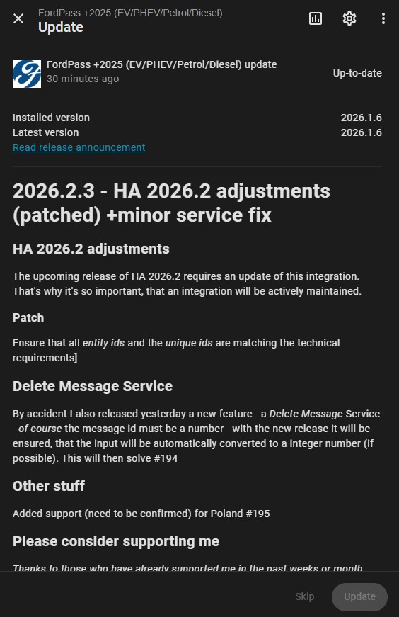

Update to the latest version of the integration
It says I’m up to date and the update button is greyed out.
edit - looks like its stuck on 2026.1.6. How can I “un-stick” it? Now I see that the latest version is 2026-2-3, but HACS is reporting the latest version as 2026-1-6 and won’t let me update.
I guess you fixed HACS because the update became available. Thanks for the quick turnaround! :+1:
Also, everything works. :+1:

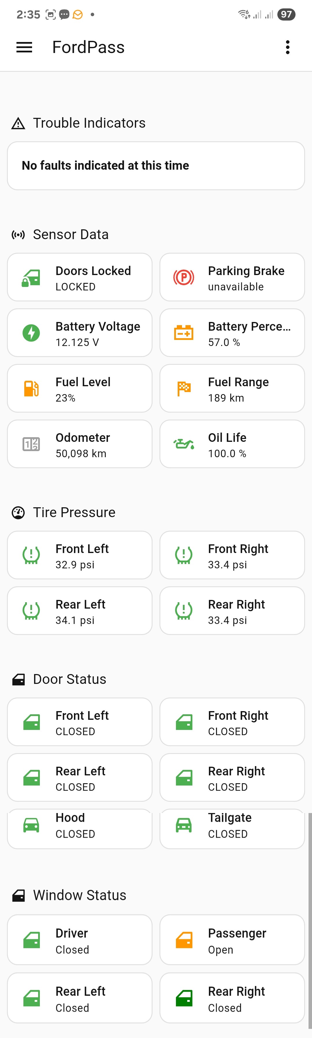

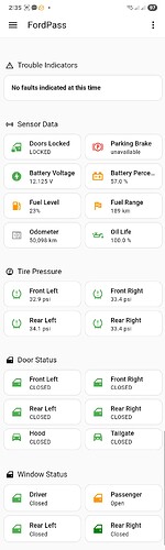

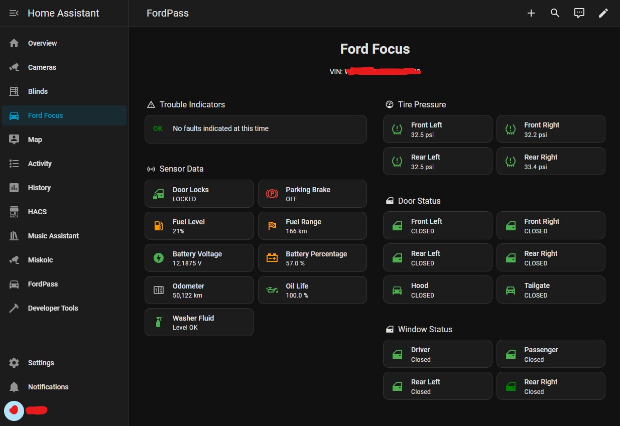

Hi. I made a dashboard with useful information that is almost a simple drop in place kind of deal. If this is the wrong place to post this, then just let me know and I’ll delete it and repost it somewhere else.
Here is the dashboard viewed on mobile.
The reason its almost drop in place is that I’m using a variable to plug the VIN in using a trick I sorted out on AI. An example:
{{ states('sensor.fordpass_' ~ states('input_text.ford_vin') ~ '_doorlock') }}
The trick is to create an input_text helper and calling it “Ford VIN” (input_text.ford_vin) and putting the VIN into the text box. This allows the dashboard to repeatedly call the VIN for use without having to type/find/replace anything. It also makes updates a lot easier too.
The other requirement is the Mushroom cards from HACS.
Instructions:
  1. Create input_text.ford_vin helper and input your VIN
  2. Install Mushroom if you don’t already have it
  3. Create a new dashboard, go to edit in YAML, delete everything and paste in the code below.

            primary: Parking Brake
            secondary: >-
              {{ states('sensor.fordpass_' ~ states('input_text.ford_vin') ~ '_parkingbrakestatus') }}
            icon: mdi:car-brake-parking
            color: >
              {{ 'green' if states('sensor.fordpass_' ~ states('input_text.ford_vin') ~ '_parkingbrakestatus') == 'ON' else 'red' }}
            primary: Battery Voltage
            secondary: >-
              {{ state_attr('sensor.fordpass_' ~ states('input_text.ford_vin') ~ '_battery', 'batteryVoltage') }} V
            icon: mdi:lightning-bolt-circle
            color: >
              {{ 'green' if state_attr('sensor.fordpass_' ~ states('input_text.ford_vin') ~ '_battery', 'batteryVoltage') > 12 else 'orange' }}
            primary: Battery Percentage
            secondary: >-
              {{ states('sensor.fordpass_' ~ states('input_text.ford_vin') ~ '_battery') }} %
            icon: mdi:car-battery
            color: >
              {%- if (states('sensor.fordpass_' ~ states('input_text.ford_vin') ~ '_battery') | int) > 70 -%}
                green
              {%- elif (states('sensor.fordpass_' ~ states('input_text.ford_vin') ~ '_battery') | int) <= 70 and (states('sensor.fordpass_' ~ states('input_text.ford_vin') ~ '_battery') | int) >= 30 -%}
                orange
              {%- else -%}
                red
              {%- endif -%}
            primary: Fuel Level
            secondary: >-
              {{ states('sensor.fordpass_' ~ states('input_text.ford_vin') ~ '_fuel') }}%
            icon: mdi:gas-station
            color: >
              {%- if (states('sensor.fordpass_' ~ states('input_text.ford_vin') ~ '_fuel') | int) > 50 -%}
                green
              {%- elif (states('sensor.fordpass_' ~ states('input_text.ford_vin') ~ '_fuel') | int) <= 50 and (states('sensor.fordpass_' ~ states('input_text.ford_vin') ~ '_fuel') | int) >= 10 -%}
                orange
              {%- else -%}
                red
              {%- endif -%}
            primary: Fuel Range
            secondary: >-
              {{ "{:,.0f}".format(state_attr('sensor.fordpass_' ~ states('input_text.ford_vin') ~ '_fuel', 'fuelRange') | int) }} {{ state_attr('sensor.fordpass_' ~ states('input_text.ford_vin') ~ '_odometer', 'unit_of_measurement') }}
            icon: mdi:flag-checkered
            color: >
                green
                orange
              {%- else -%}
                red
              {%- endif -%}
            primary: Odometer
            secondary: >-
              {{ "{:,.0f}".format(states('sensor.fordpass_' ~ states('input_text.ford_vin') ~ '_odometer') | int) }} {{ state_attr('sensor.fordpass_' ~ states('input_text.ford_vin') ~ '_odometer', 'unit_of_measurement') }}
            icon: mdi:counter
            primary: Oil Life
            secondary: >-
              {{ states('sensor.fordpass_' ~ states('input_text.ford_vin') ~ '_oil') }} %
            icon: mdi:oil
            color: >
              {%- if (states('sensor.fordpass_' ~ states('input_text.ford_vin') ~ '_oil') | int) > 50 -%}
                green
              {%- elif (states('sensor.fordpass_' ~ states('input_text.ford_vin') ~ '_oil') | int) <= 50 and (states('sensor.fordpass_' ~ states('input_text.ford_vin') ~ '_oil') | int) >= 10 -%}
                orange
              {%- else -%}
                red
              {%- endif -%}
      - type: grid
        cards:
          - type: heading
            heading: Tire Pressure
            heading_style: title
            icon: mdi:gauge
            primary: Front Left
            secondary: >
              {{ state_attr('sensor.fordpass_' ~ states('input_text.ford_vin') ~ '_tirepressure', 'frontLeft') }}
            icon: mdi:car-tire-alert
            color: >
              {{ 'green' if state_attr('sensor.fordpass_' ~ states('input_text.ford_vin') ~ '_tirepressure', 'frontLeft_state') == 'NORMAL' else 'red' }}
            primary: Front Right
            secondary: >
              {{ state_attr('sensor.fordpass_' ~ states('input_text.ford_vin') ~ '_tirepressure', 'frontRight') }}
            icon_color: >
              {{ 'green' if state_attr('sensor.fordpass_' ~ states('input_text.ford_vin') ~ '_tirepressure', 'frontRight_state') == 'NORMAL' else 'red' }}
            primary: Rear Left
            secondary: >
              {{ state_attr('sensor.fordpass_' ~ states('input_text.ford_vin') ~ '_tirepressure', 'rearLeft') }}
            icon_color: >
              {{ 'green' if state_attr('sensor.fordpass_' ~ states('input_text.ford_vin') ~ '_tirepressure', 'rearLeft_state') == 'NORMAL' else 'red' }}
            primary: Rear Right
            secondary: >
              {{ state_attr('sensor.fordpass_' ~ states('input_text.ford_vin') ~ '_tirepressure', 'rearRight') }}
            icon_color: >
              {{ 'green' if state_attr('sensor.fordpass_' ~ states('input_text.ford_vin') ~ '_tirepressure', 'rearRight_state') == 'NORMAL' else 'red' }}
          - type: heading
            heading: Door Status
            icon: mdi:car-door
            primary: Front Left
            secondary: >
              {{ state_attr('sensor.fordpass_' ~ states('input_text.ford_vin') ~ '_doorstatus', 'driverFront') }}
            icon: mdi:car-door
            color: >
              {{ 'green' if state_attr('sensor.fordpass_' ~ states('input_text.ford_vin') ~ '_doorstatus', 'driverFront') == 'CLOSED' else 'red' }}
            secondary: >
              {{ state_attr('sensor.fordpass_' ~ states('input_text.ford_vin') ~ '_doorstatus', 'passengerFront') }}
            icon: mdi:car-door
            color: >
              {{ 'green' if state_attr('sensor.fordpass_' ~ states('input_text.ford_vin') ~ '_doorstatus', 'passengerFront') == 'CLOSED' else 'red' }}
            primary: Rear Left
            secondary: >
              {{ state_attr('sensor.fordpass_' ~ states('input_text.ford_vin') ~ '_doorstatus', 'rearLeft') }}
            icon: mdi:car-door
            color: >
              {{ 'green' if state_attr('sensor.fordpass_' ~ states('input_text.ford_vin') ~ '_doorstatus', 'rearLeft') == 'CLOSED' else 'red' }}
            primary: Rear Right
            secondary: >
              {{ state_attr('sensor.fordpass_' ~ states('input_text.ford_vin') ~ '_doorstatus', 'rearRight') }}
            icon: mdi:car-door
            color: >
              {{ 'green' if state_attr('sensor.fordpass_' ~ states('input_text.ford_vin') ~ '_doorstatus', 'rearRight') == 'CLOSED' else 'red' }}
            primary: Hood
            secondary: >
              {{ state_attr('sensor.fordpass_' ~ states('input_text.ford_vin') ~ '_doorstatus', 'hood') }}
            icon: mdi:car
            color: >
              {{ 'green' if state_attr('sensor.fordpass_' ~ states('input_text.ford_vin') ~ '_doorstatus', 'hood') == 'CLOSED' else 'red' }}
            primary: Tailgate
            secondary: >
              {{ state_attr('sensor.fordpass_' ~ states('input_text.ford_vin') ~ '_doorstatus', 'tailgate') }}
            icon: mdi:car-back
            color: >
              {{ 'green' if state_attr('sensor.fordpass_' ~ states('input_text.ford_vin') ~ '_doorstatus', 'tailgate') == 'CLOSED' else 'red' }}
          - type: heading
            heading: Window Status
            icon: mdi:car-door
            primary: Driver
            secondary: >
              {{ 'Open' if (state_attr('sensor.fordpass_' ~ states('input_text.ford_vin') ~ '_windowposition', 'driver').doubleRange.lowerBound != 0.0 or state_attr('sensor.fordpass_' ~ states('input_text.ford_vin') ~ '_windowposition', 'driver').doubleRange.lowerBound != 0.0) else 'Closed' }}
            icon: mdi:car-door
            icon_color: >
              {{ 'orange' if (state_attr('sensor.fordpass_' ~ states('input_text.ford_vin') ~ '_windowposition', 'driver').doubleRange.lowerBound != 0.0 or state_attr('sensor.fordpass_' ~ states('input_text.ford_vin') ~ '_windowposition', 'driver').doubleRange.lowerBound != 0.0) else 'green' }}
            primary: Passenger
            secondary: >
              {{ 'Open' if (state_attr('sensor.fordpass_' ~ states('input_text.ford_vin') ~ '_windowposition', 'passenger').doubleRange.lowerBound != 0.0 or state_attr('sensor.fordpass_' ~ states('input_text.ford_vin') ~ '_windowposition', 'passenger').doubleRange.lowerBound != 0.0) else 'Closed' }}
            icon: mdi:car-door
            icon_color: >
              {{ 'orange' if (state_attr('sensor.fordpass_' ~ states('input_text.ford_vin') ~ '_windowposition', 'passenger').doubleRange.lowerBound != 0.0 or state_attr('sensor.fordpass_' ~ states('input_text.ford_vin') ~ '_windowposition', 'passenger').doubleRange.lowerBound != 0.0) else 'green' }}
            primary: Rear Left
            secondary: >
              {{ 'Open' if (state_attr('sensor.fordpass_' ~ states('input_text.ford_vin') ~ '_windowposition', 'rearDriver').doubleRange.lowerBound != 0.0 or state_attr('sensor.fordpass_' ~ states('input_text.ford_vin') ~ '_windowposition', 'rearDriver').doubleRange.lowerBound != 0.0) else 'Closed' }}
            icon: mdi:car-door
            icon_color: >
              {{ 'orange' if (state_attr('sensor.fordpass_' ~ states('input_text.ford_vin') ~ '_windowposition', 'rearDriver').doubleRange.lowerBound != 0.0 or state_attr('sensor.fordpass_' ~ states('input_text.ford_vin') ~ '_windowposition', 'rearDriver').doubleRange.lowerBound != 0.0) else 'green' }}
            primary: Rear Right
            secondary: >
              {{ 'Open' if (state_attr('sensor.fordpass_' ~ states('input_text.ford_vin') ~ '_windowposition', 'rearPassenger').doubleRange.lowerBound != 0.0 or state_attr('sensor.fordpass_' ~ states('input_text.ford_vin') ~ '_windowposition', 'rearPassenger').doubleRange.lowerBound != 0.0) else 'Closed' }}
            icon: mdi:car-door
            icon_color: >
              {{ 'Orange' if (state_attr('sensor.fordpass_' ~ states('input_text.ford_vin') ~ '_windowposition', 'rearPassenger').doubleRange.lowerBound != 0.0 or state_attr('sensor.fordpass_' ~ states('input_text.ford_vin') ~ '_windowposition', 'rearPassenger').doubleRange.lowerBound != 0.0) else 'Green' }}
    cards: []
    header: {}
I hope this is useful. I think it is. Right now its geared toward gas cars because that’s what I have. Also, it only works with 1 car right now. I do plan to change the input_text.ford_vin to an array when I get a chance, which could allow any number of cars.

Small update - added lock entity and washer fluid level, as well as a header.
To make the lock work, go to line 73 and change entity: lock.fordpass_YOURVINHERE_doorlock to your vin. Or you can change it in the visual editor where it will show as unavailable until you replace it. It displays the state perfectly fine without doing anything, but if you fix the entity, you can click on it to take action on the lock (Lock/Unlock).
The washer fluid does not report a percentage or anything meaningful. Its simply the inverse of the lowwasherfluid_600E19 indicator. False = OK, True = low fluid level. If true, it will also appear in the indicators card.
Instructions as before:
  1. create input_text.ford_vin and input your VIN
  2. install Mushroom cards
  3. create a new dashboard, go to YAML, delete everything and paste in the below code.
    3a) if you already installed it, just delete the YAML and paste in the below.
views:
  - title: FordPass
    type: sections
    max_columns: 4
    sections:
      - type: grid
        cards:
          - type: heading
            heading: Trouble Indicators
            icon: mdi:alert-outline
          - type: markdown
            content: >
              {%- set sensor ='sensor.fordpass_' ~ states('input_text.ford_vin') ~ '_indicators' -%} {%- set faults = [] -%}
              {%- if state_attr(sensor, 'adaptivecruisecontrol_600E14') == true -%}{%- set faults = faults + ['Adaptive Cruise Control'] -%}{%- endif -%}
              {%- if state_attr(sensor, 'airfilterminder_600E02') == true -%}{%- set faults = faults + ['Air Filter Minder'] -%}{%- endif -%}
              {%- if state_attr(sensor, 'airsuspensionridecontrolfault_600E22') == true -%}{%- set faults = faults + ['Air Suspension Control Fault'] -%}{%- endif -%}
              {%- if state_attr(sensor, 'allwheeldrivedisabled_600E03') == true -%}{%- set faults = faults + ['All-Wheel Drive Disabled'] -%}{%- endif -%}
              {%- if state_attr(sensor, 'antitheft_600E21') == true -%}{%- set faults = faults + ['Antitheft Device'] -%}{%- endif -%}
              {%- if state_attr(sensor, 'antilockbrake_600E29') == true -%}{%- set faults = faults + ['Antilock Brakes'] -%}{%- endif -%}
              {%- if state_attr(sensor, 'blindspotdetection_600F30') == true -%}{%- set faults = faults + ['Blind Spot Detection System'] -%}{%- endif -%}
              {%- if state_attr(sensor, 'brakewarning_600E28') == true -%}{%- set faults = faults + ['Brake Warning'] -%}{%- endif -%}
              {%- if state_attr(sensor, 'chargesystemfault_600E25') == true -%}{%- set faults = faults + ['Charge System Fault'] -%}{%- endif -%}
              {%- if state_attr(sensor, 'checkfuelcap_600E13') == true -%}{%- set faults = faults + ['Check Fuel Cap'] -%}{%- endif -%}
              {%- if state_attr(sensor, 'checkfuelfillinlet_600E12') == true -%}{%- set faults = faults + ['Check Fuel Inlet'] -%}{%- endif -%}
              {%- if state_attr(sensor, 'dieselengineidleshutdown_600E05') == true -%}{%- set faults = faults + ['Diesel Engine Idle Shutdown'] -%}{%- endif -%}
              {%- if state_attr(sensor, 'dieselenginewarning_600E06') == true -%}{%- set faults = faults + ['Diesel Engine Warning'] -%}{%- endif -%}
              {%- if state_attr(sensor, 'dieselexhaustfluidlow_600F27') == true -%}{%- set faults = faults + ['Diesel Exhaust Fluid Low'] -%}{%- endif -%}
              {%- if state_attr(sensor, 'dieselexhaustfluidsystemfault_600F26') == true -%}{%- set faults = faults + ['Diesel Exhaust Fluid System'] -%}{%- endif -%}
              {%- if state_attr(sensor, 'dieselexhaustovertemp_600E08') == true -%}{%- set faults = faults + ['Diesel Exhaust Over Temperature'] -%}{%- endif -%}
              {%- if state_attr(sensor, 'dieselparticulatefilter_600E07') == true -%}{%- set faults = faults + ['Diesel Particulate Filter'] -%}{%- endif -%}
              {%- if state_attr(sensor, 'dieselpreheat_600E09') == true -%}{%- set faults = faults + ['Diesel Pre-Heat'] -%}{%- endif -%}
              {%- if state_attr(sensor, 'electrictrailerbrakeconnection_600E18') == true -%}{%- set faults = faults + ['Electric Trailer Brake Connection'] -%}{%- endif -%}
              {%- if state_attr(sensor, 'electronicparkingbrakewarning_600F15') == true -%}{%- set faults = faults + ['Electronic Parking Brake Warning'] -%}{%- endif -%}
              {%- if state_attr(sensor, 'enginecoolantovertemp_600E16') == true -%}{%- set faults = faults + ['Engine Coolant Over Temperature'] -%}{%- endif -%}
              {%- if state_attr(sensor, 'fastenseatbeltwarning_600E31') == true -%}{%- set faults = faults + ['Fasten Seat Belt Warning'] -%}{%- endif -%}
              {%- if state_attr(sensor, 'forwardcollisionwarning_600E00') == true -%}{%- set faults = faults + ['Forward Collision Warning System'] -%}{%- endif -%}
              {%- if state_attr(sensor, 'fueldooropen_600E11') == true -%}{%- set faults = faults + ['Fuel Door Open'] -%}{%- endif -%}
              {%- if state_attr(sensor, 'gasparticulatefilterwarning_600F18') == true -%}{%- set faults = faults + ['Gas Particulate Filter Warning'] -%}{%- endif -%}
              {%- if state_attr(sensor, 'genericabsfaultwarning_600F17') == true -%}{%- set faults = faults + ['Generic ABS Failure Warning'] -%}{%- endif -%}
              {%- if state_attr(sensor, 'hevhazard_600F19') == true -%}{%- set faults = faults + ['HEV Hazard'] -%}{%- endif -%}
              {%- if state_attr(sensor, 'hilldescentcontrolfault_600F25') == true -%}{%- set faults = faults + ['Hill Descent Control System'] -%}{%- endif -%}
              {%- if state_attr(sensor, 'hillstartassistwarning_600F22') == true -%}{%- set faults = faults + ['Hill Start Assist Warning'] -%}{%- endif -%}
              {%- if state_attr(sensor, 'lanekeepingaid_600F24') == true -%}{%- set faults = faults + ['Lane Keeping Aid'] -%}{%- endif -%}
              {%- if state_attr(sensor, 'lightingsystemfailure_600F21') == true -%}{%- set faults = faults + ['Lighting System Failure'] -%}{%- endif -%}
              {%- if state_attr(sensor, 'lowbrakefluid_600F16') == true -%}{%- set faults = faults + ['Low Brake Fluid'] -%}{%- endif -%}
              {%- if state_attr(sensor, 'lowengineoilpressure_600E17') == true -%}{%- set faults = faults + ['Low Engine Oil Pressure'] -%}{%- endif -%}
              {%- if state_attr(sensor, 'lowfuel_600E20') == true -%}{%- set faults = faults + ['Low Fuel'] -%}{%- endif -%}
              {%- if state_attr(sensor, 'lowwasherfluid_600E19') == true -%}{%- set faults = faults + ['Low Washer Fluid'] -%}{%- endif -%}
              {%- if state_attr(sensor, 'malfunctionindicator_600E26') == true -%}{%- set faults = faults + ['Malfunction Indicator'] -%}{%- endif -%}
              {%- if state_attr(sensor, 'parkaidmalfunction_600E01') == true -%}{%- set faults = faults + ['Paring Aid Malfunction'] -%}{%- endif -%}
              {%- if state_attr(sensor, 'passiveentrypassivestart_600E04') == true -%}{%- set faults = faults + ['Passive Entry Passive Start'] -%}{%- endif -%}
              {%- if state_attr(sensor, 'powertrainmalfunction_600E15') == true -%}{%- set faults = faults + ['Powertrain Malfunction'] -%}{%- endif -%}
              {%- if state_attr(sensor, 'restraintsindicatorwarning_600E30') == true -%}{%- set faults = faults + ['Restraint Indicator Warning']-%}{%- endif -%}
              {%- if state_attr(sensor, 'servicesteering_600F29') == true -%}{%- set faults = faults + ['Service Steering'] -%}{%- endif -%}
              {%- if state_attr(sensor, 'startstopenginewarning_600F20') == true -%}{%- set faults = faults + ['Start-Stop Engine Warning'] -%}{%- endif -%}
              {%- if state_attr(sensor, 'tractioncontroldisabled_600E23') == true -%}{%- set faults = faults + ['Traction Control Disabled'] -%}{%- endif -%}
              {%- if state_attr(sensor, 'tractioncontrolevent_600E24') == true -%}{%- set faults = faults + ['Traction Control Event'] -%}{%- endif -%}
              {%- if state_attr(sensor, 'tirepressuremonistersystemwarning_600E27') == true -%}{%- set faults = faults + ['Tire Pressure Monitoring System'] -%}{%- endif -%}
              {%- if state_attr(sensor, 'waterinfuel_600E10') == true -%}{%- set faults = faults + ['Water In Fuel'] -%}{%- endif -%}
              {% if faults | length > 0 %}
                {% for fault in faults %}
              * <font color="red">**FAULT**</font> - {{ fault }}
                {% endfor %}
              {% else %}
                <font color="green">**OK**</font> &nbsp;&nbsp;&nbsp;&nbsp; No faults indicated at this time
              {% endif %}
          - type: heading
            heading: Sensor Data
            icon: mdi:access-point

                red
              {%- endif -%}
            secondary: >-
            color: >
            secondary: >-
            color: >
                green
                orange
              {%- else -%}
                red
              {%- endif -%}
            primary: Odometer
            secondary: >-
            icon: mdi:counter
            primary: Oil Life
            secondary: >-
            icon: mdi:oil
            color: >
                green
                orange
              {%- else -%}
                red
              {%- endif -%}
            primary: Washer Fluid
            secondary: >-
              {%- if state_attr('sensor.fordpass_' ~ states('input_text.ford_vin') ~ '_indicators', 'lowwasherfluid_600E19') == false -%}
                Level OK
              {%- else -%}
                Low Fluid Level
              {%- endif -%}
            icon: mdi:spray-bottle
            color: >
                green
              {%- else -%}
                orange
              {%- endif -%}
      - type: grid
        cards:
          - type: heading
            icon: mdi:gauge
            primary: Front Left
            secondary: >
            color: >
            secondary: >
            icon_color: >
            primary: Rear Left
            secondary: >
            icon_color: >
            primary: Rear Right
            secondary: >
            icon_color: >
          - type: heading
            icon: mdi:car-door
            primary: Front Left
            secondary: >
            icon: mdi:car-door
            color: >
            secondary: >
            icon: mdi:car-door
            color: >
            primary: Rear Left
            secondary: >
            icon: mdi:car-door
            color: >
            primary: Rear Right
            secondary: >
            icon: mdi:car-door
            color: >
            primary: Hood
            secondary: >
            icon: mdi:car
            color: >
            primary: Tailgate
            secondary: >
            icon: mdi:car-back
            color: >
          - type: heading
            icon: mdi:car-door
            primary: Driver
            secondary: >
            icon: mdi:car-door
            icon_color: >
            primary: Passenger
            secondary: >
            icon: mdi:car-door
            icon_color: >
            primary: Rear Left
            secondary: >
            icon: mdi:car-door
            icon_color: >
            primary: Rear Right
            secondary: >
            icon: mdi:car-door
            icon_color: >
    cards: []
    header:
      card:
        type: markdown
        text_only: true
        content: |
          # Ford Car
          VIN: {{ states('input_text.ford_vin') | upper }}
