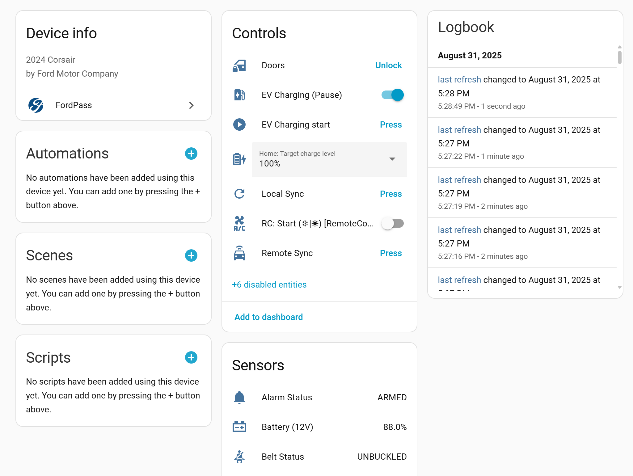

What has started just as a fork of the HACS default FordPass integration from itchannel and SquidBytes, by cleaning-up & document the current required unusual integration setup process, have morphed into an independent repository/development. Now supporting basic HA features like unit converters or translations [en/de] for the entity names and can be used as source for EVCC
But the biggest difference is, that instead of polling updates in a specified interval, the integration makes use ob websocket communication - so your HA will receive new data as soon as it arrives at FordPass servers (does not have to be in the moment, you actually do something with your car), but e.g. when you lock/unlock your car with the default FordPass App on your mobile device, you will instantly see the change in HA.
