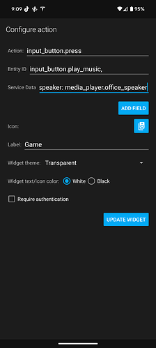

I am trying to create a few action button widgets for my phone where with one press I can play my preferred music on a given speaker. I have this working with a simple automation where the speaker is hardcoded into the automation. I thought it’d be “trivial” to extract the speaker name into a variable to be passed from the widget so I can hard code each widget with the speaker I want it to play on.

I have tried numerous versions of passing the data through the widget but can’t seem to find the magic to get it to work.
Usually I get something along the lines of
extra keys not allowed @ data['service_data'] in the logs so I can’t even see what the body of the message looks like to process it.
