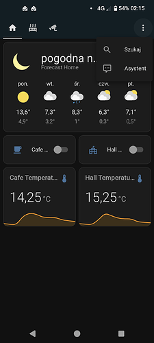

your missing the hamburger menu on the left side in the screenshot, check your frontend configuration looks like you are hiding it. The menu moved to Settings > Companion App and only accessible from the app

top left corner should have the hamburger menu, how else do you access automations and setting up devices etc…?
do you have a custom dashboard? or did you setup a view as a subview? thats the only way i know its possible to lose that button.

Looks like you need to speak to whoever set up your access and ask them wth they did to lock you out of the sidebar.
The owner of the system can install custom plugins and hide the hamburger menu for every user or for users that are not admins. If you are not the owner or admin, it would be difficult for you to remove the restrictions.
You can detect if something was hidden with some plugin if you connect to your phone through ADB. Follow these instructions and you can debug the WebView of Home Assistant and detect what is hiding the hamburger menu.
