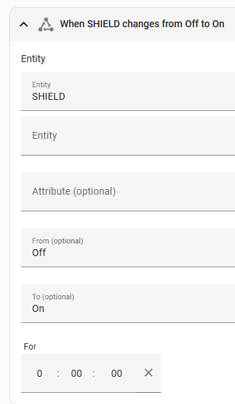

Update 5/2/25 - TASKER stopped working, switched to Android TV remote, works great
UPDATE: a couple weeks ago tasker just stopped working. I didn’t even bother trouble shooting it so it could be something simple. HOWEVER miraculously adding the “Android TV Remote” seems to now be very reliable for reporting the state of the Shield (believe me it was NOT for a while). Note: Android Debug bridge works too but has a VERY slow polling rate. I made 2 automations: one for ON one for OFF. Its Working basically just as well as the webhook I used before.
I use both integrations so shield’s in there twice as ADB has features
