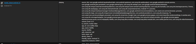

I tried this one, but I changed to netflix and some times just to see how it responds but it is still “unknown”

Thank you, so this sensor seems to work now:
template:
  - sensor:
      - name: Android TV Source
        state: "{{ state_attr('media_player.example', 'source') }}"
I get the correct value back now e.g. “Netflix”
So lets see if I can properly trigger on it :slight_smile:
