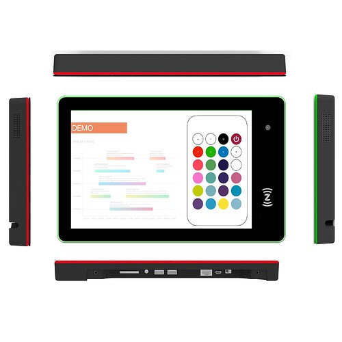

I have a wall-mounted Android POE-enabled tablet which I’ve successfully connected to the Android TV integration. The tablet contains an outer LED frame that can be controlled by issuing an ADB command to a mounted device ("echo w 0x05 > ./sys/devices/platform/led_con_h/zigbee_reset").

@Patrick_C Can you share the model of you Android POE device? Thx!
Sure, the model itself is a no-name chinese one. As with nearly all kind of chinese tablets, the tablet comes without any kind of security updates but is already pre-rooted and works for my intended usage like a charm (Fully Kiosk Browser locked, ADB via Ethernet).
