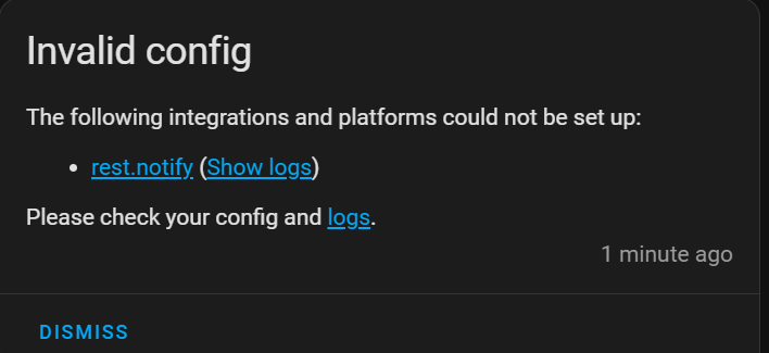

I’m currently using Notifications of Android TV Integration and it has built-in code for assigning a device as a notify object. I find TVOverlay to be a very interesting alternative with +1 features. However, I cannot determine how to integrate it with HA. Please could you provide some straight forward instruction?
Thanks.
When I copy/paste code in link into configuration.yaml file and restart HA I get this:
