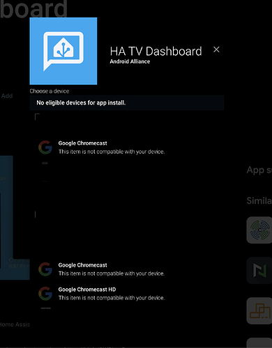

Tried to find this app on my chromecast and it wasn’t there. Not sure how i can get it on my tv to try but it looks pretty. When i try to download this on the play store directly, it says my devices aren’t compatible. I have all Chromecasts with Google TV
Here’s what i see. and my chromecast doesn’t find this at all.

Thanks for the feedback, this is valuable. but it is also quite peculiar, I created a new account and tested and have the same result as you, however, looking at the Play Console Device catalog.
I will investigate further and push a new update once I have a solution.

That probably means that your TV doesn’t fit the required criteria, is it running Android 12?
If you post the TV name and Model and Android OS version I can search like I show in the screenshot above.
Otherwise I will make the APK available on the Wiki Page and you can attempt to sideload it, but I doubt it will work as expected.
