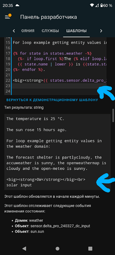

does this template render in dev tools > templates?
<big><strong>{{ states.sensor.delta_pro_240327_dc_input.state | int }}W</strong></big><br>        solar input
Yes, this this template rendered fine in dev tools > templates:
This template widget worked fine until recent HA update.
