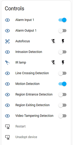

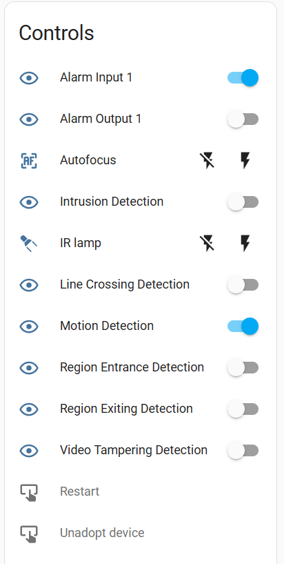

The Hikvision integration works with Annke as they’re the same kit.
You can also change settings with a command line switch as per this thread
First of all Thank you for your reply.
I already try to use this integration mentioned whiout sucess to control the white light led, this option is not available over the controls also over this integration …
Please let me know if you have any other way
Thank you
hello. how did you manage to make those settings appear?
What model of annke are you using?
I want to use FCD800. will it work?
