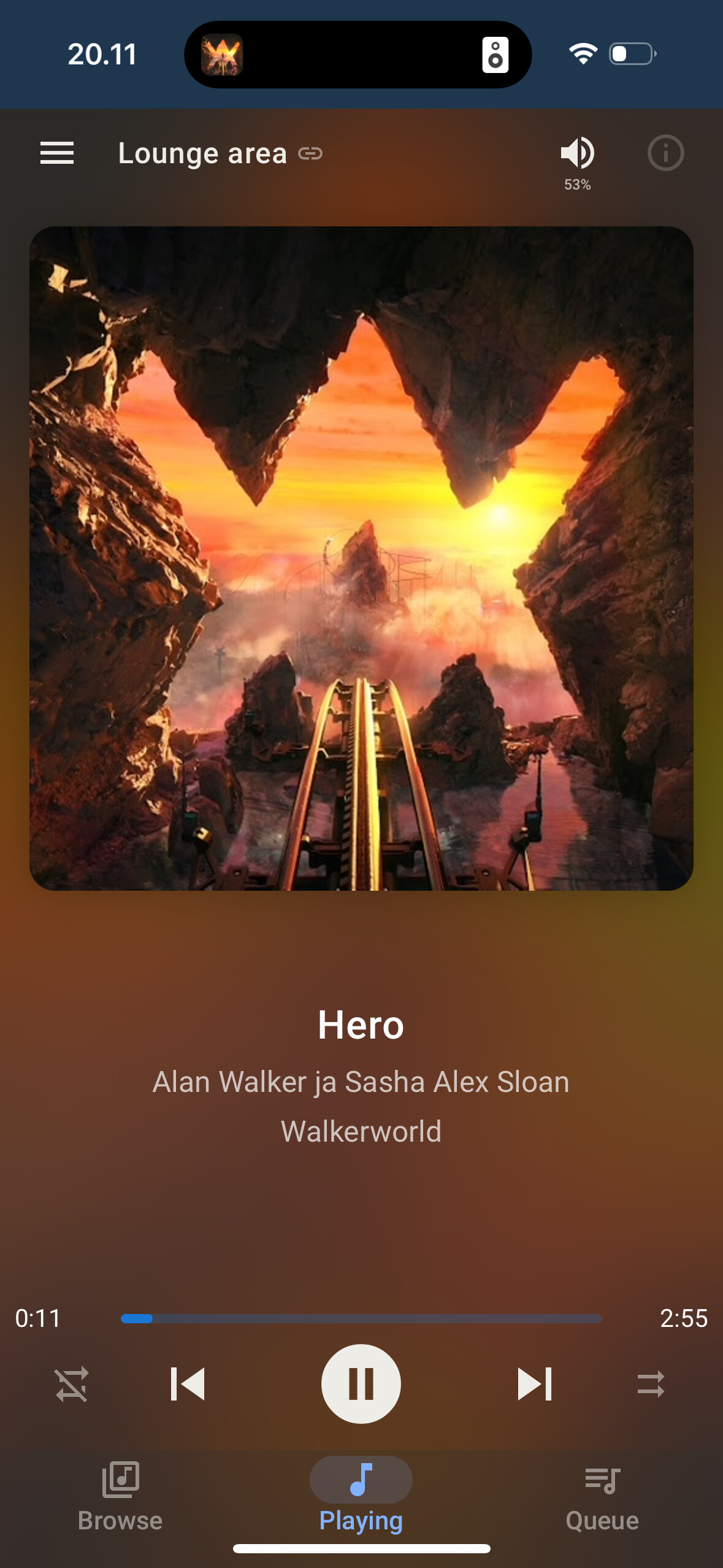

Hi @jussbba I don’t use airplay I’m afraid so can’t test this, but I guess LMS just sees it as a continuous stream. If you look in material or the like when you’re streaming, can you see track length and position in track in the UI?
Yes I can see the track lenght and postition, but after the announcement is finished, it jumps back to the beginning of the track. The track position changes (the track is playing) on youtube music app when the tts is played but when the old playlist starts again, the playback jumps to the start of the song.
I had a look at this earlier and I think it’s a limitation in the way shairtunes works. I saw your comment in the shairtunes thread, and your summary is right - we save the current playlist and its status (playing state, position in track, repeat etc.), play the announcement and then restore all the prior settings. But, we’re just restoring those settings on the LMS and its queue. I can’t quite get my head around how that would work with an something actually running on some idevice. LMS would have to control that device to pass these settings back to youtube music for eg. I’ll add something in the shairtunes discussion - I’ll need feedback from philippe as to whether we can support this.
