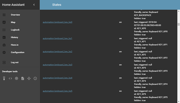

Its not real without a screenshot
Screenshot Please…
here is the table with the transparent rows - as opposed to them being white:
Can anyone please tell me which line affects the developer tools icons? Also, has anyone been successful with changing the initial color (unselected) of the icons to the left of overview, map, logbook, history, etc.
Try sidebar-icon-color:
I’m pretty sure this does both the sidebar (unselected) icons and the developer tools icons.
That worked. Thank you.
