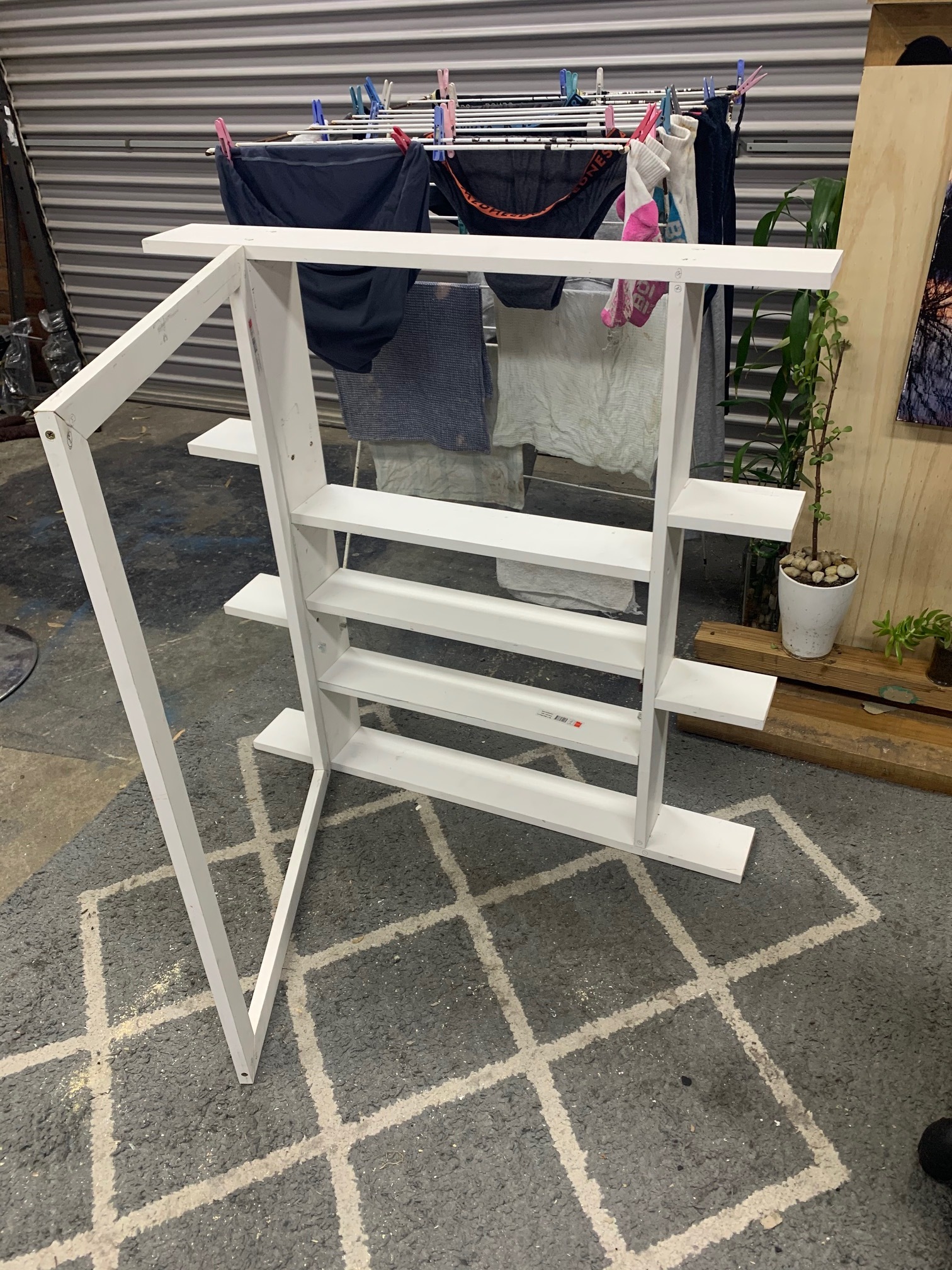

Anyway, I have been doing bathroom (ensuite) renovations at home for a month or so and liked the idea of a Magic Mirror for the new bathroom however decided to take advantage of the Home Assistant automation that I’ve started to implement. We have been working to a tight budget so I decided to make it myself to try and save some money. The design is based on another bathroom cabinet I saw somewhere however was made a lot larger (mirror 600mm x 900mm) to fit an old HDMI monitor I had lying around. The quote for the 2 way mirror glass just about gave me a heart attack so I’ve gone cheap and used clear acrylic with reflective film on it until I can save for the real thing. I’ve fitted a PI Zero W which does work ok but it is sooo slow that I’ll probably go back to the PI 3B+ at some stage. The view in the image is based on a layout card but there are still some things to add to it yet.
Next step is to fit a PIR I already have which will power up the monitor when someone walks into the bathroom (note the Magic Mirror switch in the view). This is using an Arlec smart power adapter that I’ve flashed with Tasmota (another awesome development - I’ve got a few of these) to take it out of the cloud. Tasmota is part of another strategic decision on my part not to use cloud products so I can have at least some control over my destiny. Home Assistant makes this so easy with the MQTT interface.
