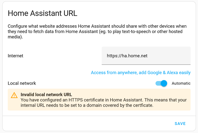

Everything works. However, when I go to the System > Network, I get the following error message:
Can someone explain why HA is complaining about a "local network URL?
Keep in mind that if I use https://ha.home.net everything works…
Delete the internet address, turn off “use automatic” for the local and add the address in there.
Just funny… I have been around this for a day and would never assign the name to the local network as it says “automatic”. Shame on me!
Thank you!
