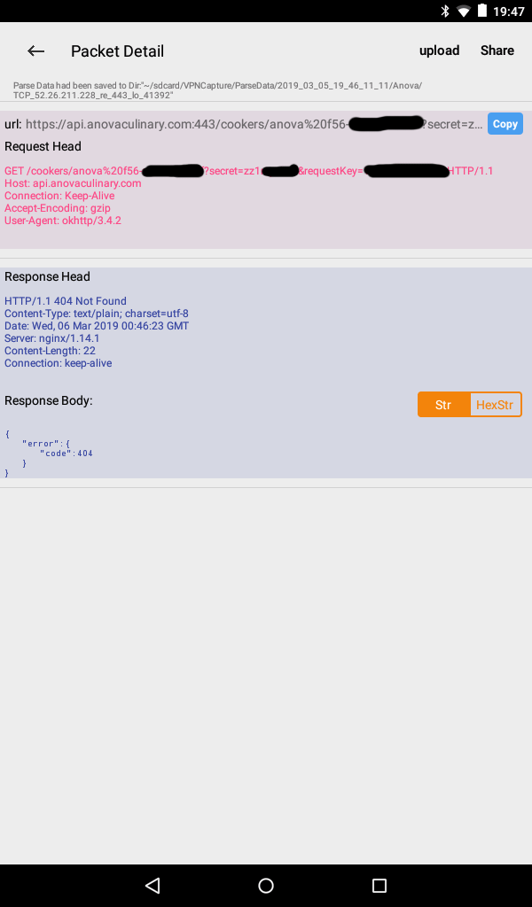

Pulled out my Nexus 7 tablet and got it working on that. Now which packet/fields were you able to find things in?
It will be an HTTPS call to api.anovaculinary.com You are looking for one that has the cooker ID and secret in the request like this:
That f56-xxxxxxxxxxx is the cooker ID.
Perfect thanks, I thought it might be in the header but wasn’t sure.

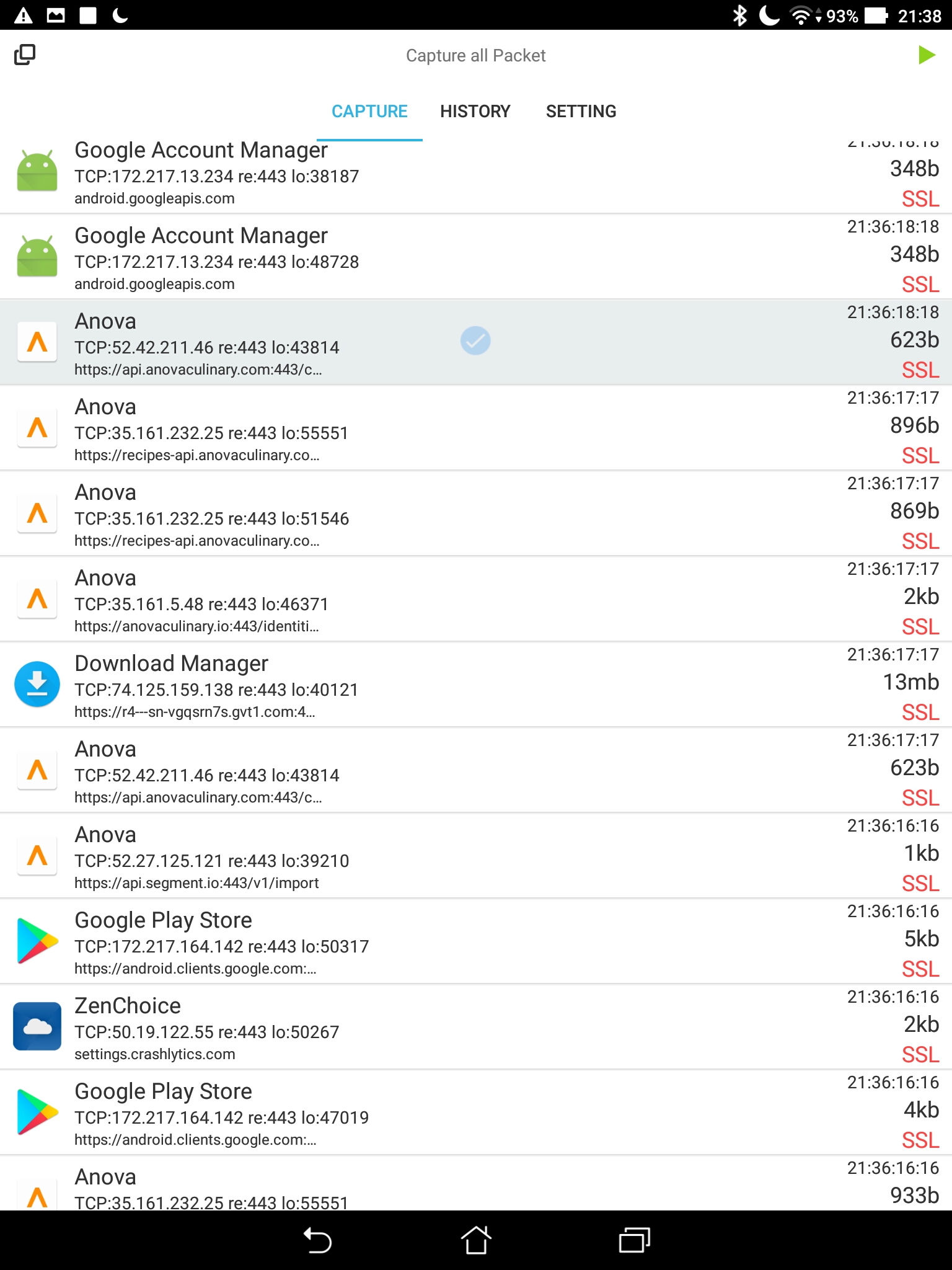

Interesting, So I fired my capture back up and I do see those calls to api.segment.io and anovaculinary.io.
Mixed in though are the api.anovaculinary.com calls. I see the tokens you are talking about in the other ones but I’m not using either of those domains and my control is working correctly so maybe those are some sort of telemetry domains? I really don’t know. It’s also entirely possible the new cooker is using a different API altogether.
A couple of screenshots:
I’ll run it for longer another day. Travelling this weekend. I’m fairly certain the segments.io is a tracking API, not sure about anovaculinary.io. How frequent are the api.anovaculinary.com calls?
It looks like roughly every 1 in 4 calls from the app is api.anovaculinary.com. You should get them though just by firing up the app with the packet capture running. You do have it paired to the cooker right? Make sure the Anova app has been killed. Fire up the packet capture then fire up the Anova app. You should get calls pretty quick to the API. I would say less than 60 seconds you will have them. At least that’s how it is with my cooker.
I’ll try killing the app first, but i’m definitely not seeing them 1 in 4 calls. And yes I have the cooker paired.
Well that sucks.
Sounds like the new cooker is using a new API. It also sounds like mine may be using both in parallel or maybe the app is just using both to support the old and new cookers. I’m all out of ideas then since I don’t have a new cooker to play with.
Just for reference, here’s some of the packets I’m getting. I tried again killing the app/fresh starting and i got some different/unique hits but still nothing to api.anovaculinary.com.
