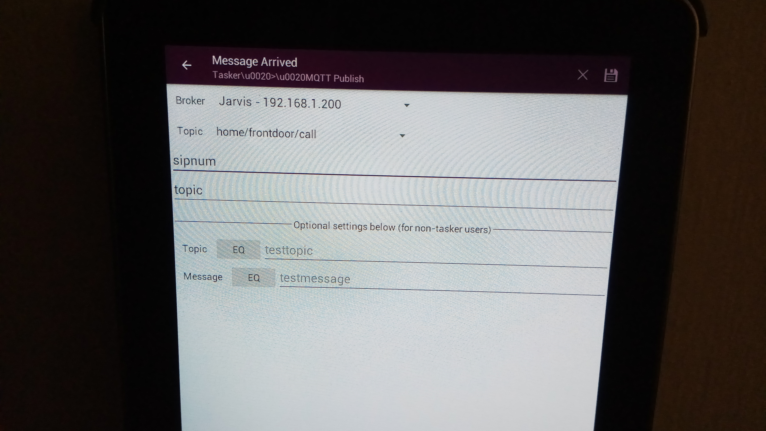

Now open Tasker. Under Profiles tab, click on the + button on the bottom right. Select Event > Plugin > MQTT Client > Message Arrived. Edit the Configuration. Select the topic home/frontdoor/call and enter sipnum for varmessage and topic for varmqtttopic. Click save.
