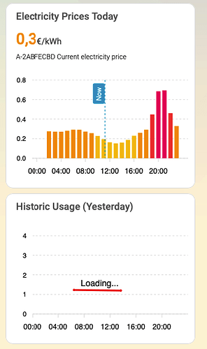

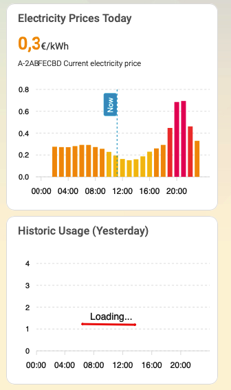

I also used ApexCharts to present the electricity pricing and historical data but that only worked for a few days.
The pricing graph works fine as you can see but the historical data stopped presenting the data. It now just shows 'loading'.
Have you seen similar scenario's?
