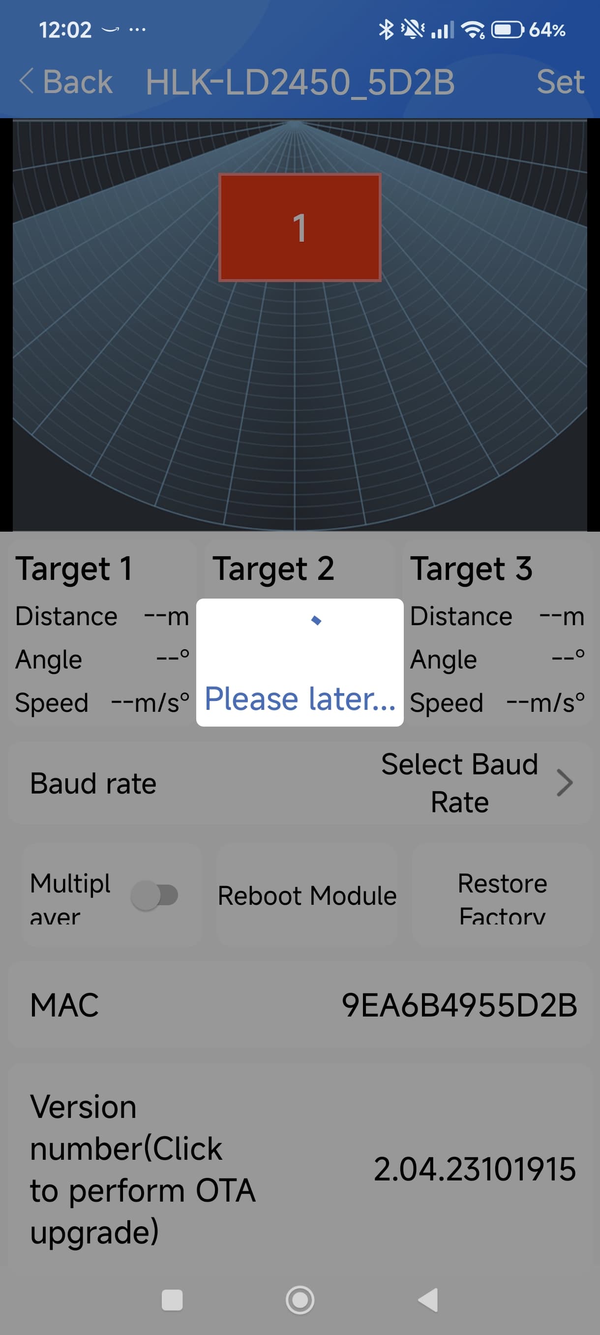

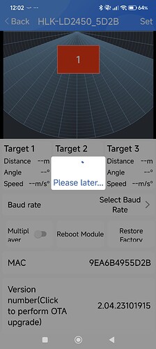

I also had big big trouble using the HLK Radar tool which is their preferred method for setting up your 2450 zones. I’m using the latest version of the HLK tool, I have a modern android phone, my bluetooth never has a problem. I’ve got bluetooth turned on the 2450 chip, And while it finds it during the scan, it is so laggy and slow and even closes up at times that it’s impossible to work with, even for one zone which was my use case. Maybe their bluetooth antenna is terrible. I don’t know.

I just got a few of these and I'm really struggling to calibrate them too. That app has so much potential, but its unstable connection drives me crazy!
