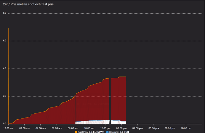

Hi!
I have a fixed electricity price, I have an apexcard that shows what my electricity is and in the same graph I have what it should have been if I have had an hourly tariff (nordpool)
But it seems like it resets every hour and calculates the imported electricity with the new hourly price, so if the next hour is cheaper it will calculate the latest price with the imported electricity and it is less than the hour before. I want it to calculate the price for every hour and add on to the next if you understand what I’m trying to explain :slight_smile:
The white graph is nordpool integration.
I have made a sensor that looks like this:
experiment_nordpool_import:
        friendly_name: "Jämför med spotpris"
        unit_of_measurement: "EUR"
        value_template: "{{ states('sensor.grid_import_solar_daily_energy') | float * states('sensor.nordpool_kwh_fi_eur_3_10_024') | float }}"
