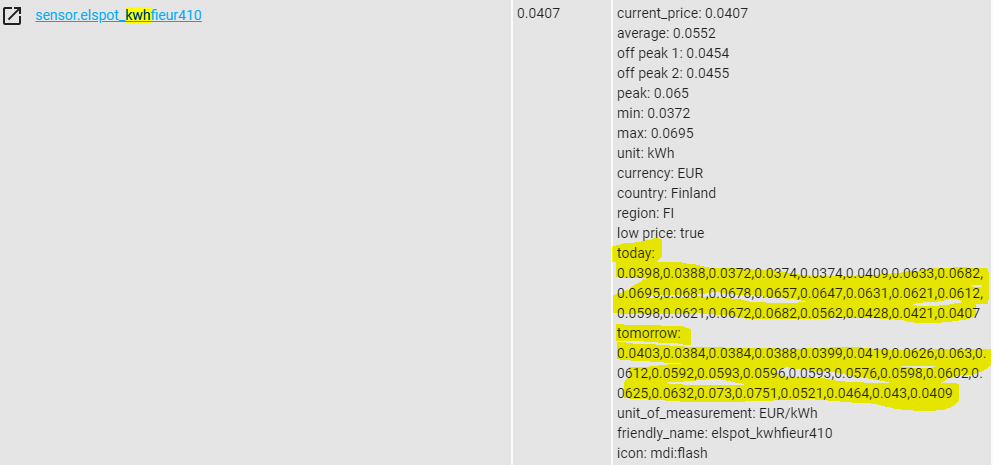

You might look into this custom component, I am using latest development version now and it proved to work very well so far:
https://bitbucket.org/OlavAndre/nordpool/wiki/Home
great, thanks will have a look
Thanks, works great!
Thanks! Works great also here.
Wishlist would include a graph for day-ahead-prices (the future hours). :slight_smile:

This custom component is working pretty nicely, but how i could make today and tomorrow as graph? And best if i could make some colors, like green for below 0,005€ and red beyond?
is your current price shifted for your timezone or you get prices by CEST (Swedish time)?
Actually it is one hour off, so i have to figure out how to fix that too.
And also it would be nice to add that extra 0,003€ fee for electric company.
you might be interested to read through this:
https://github.com/custom-components/nordpool/pull/4#event-2642324775
There is a macro that can help you add fees. Note that there are some brackets missing from tariff formulas, but these are easy to find.
Timezone error still seems to be a bug in code. Hope that this gets solved at some point.
