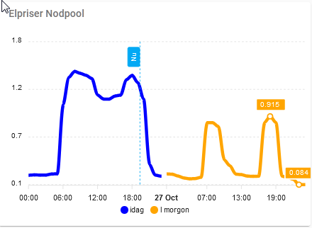

This is also visually shown in a chart where the green line shows the “low” limit and the red line shows the “high” limit. When the price has been above or under the limits, it lights up in green og red:
