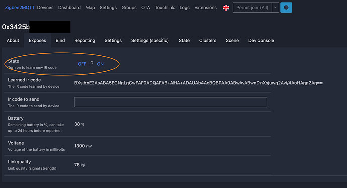

The most basic way I have found, record as many IR remote buttons as you need using these steps.
  1. Go to you Zigbee2MQTT web console, find the Moes IR device, go to the ‘Exposes’ tab for the device.
  2. Turn on the ‘State’ switch for the device as is shown in picture below.
  3. Aim your IR remote a the Moes IR device and press the desired button on the remote.
  4. The raw IR code in base 64 will appear in field below this switch.
  5. copy this raw code into some kind of document to track you codes with the IR remote button name.
  6. Then as is shown in example bash script code below, you can send this code to the Moes IR device using MQTT message. Expand on this to create in Home Assistant a switch or automation using HA’s ability to send MQTT messages.
