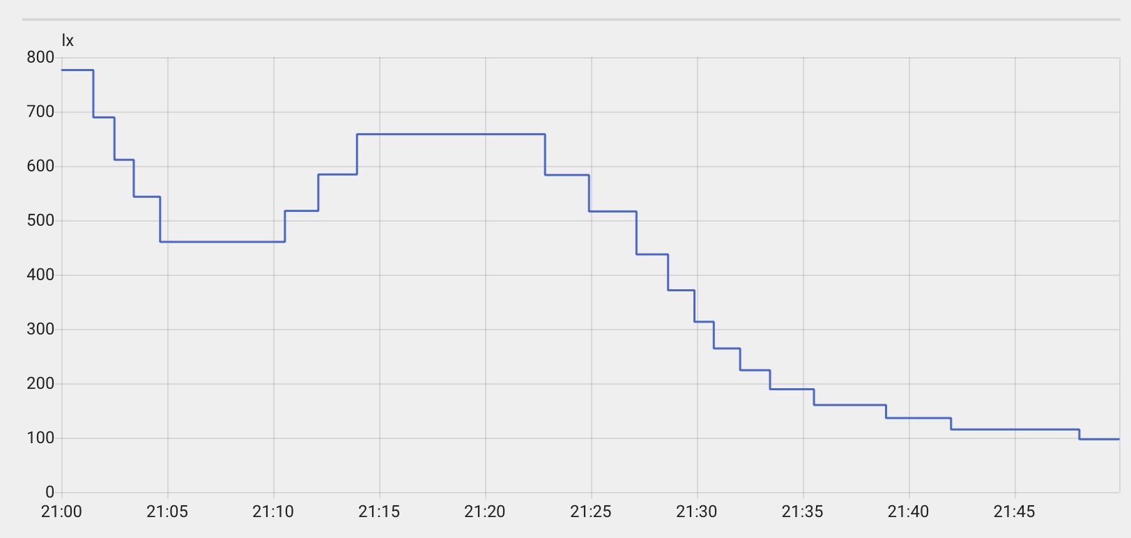

I’m a big fan of these. Very accurate and last a long time on battery (if I would need to guess over a year) but increasingly hard to find. Ignore the Homekit, it is Zigbee. I have it on ZHA:
To get a sense of the reporting frequency, this is now, late summer evening, outside (shielded from rain by a thin transparent plastic cover):

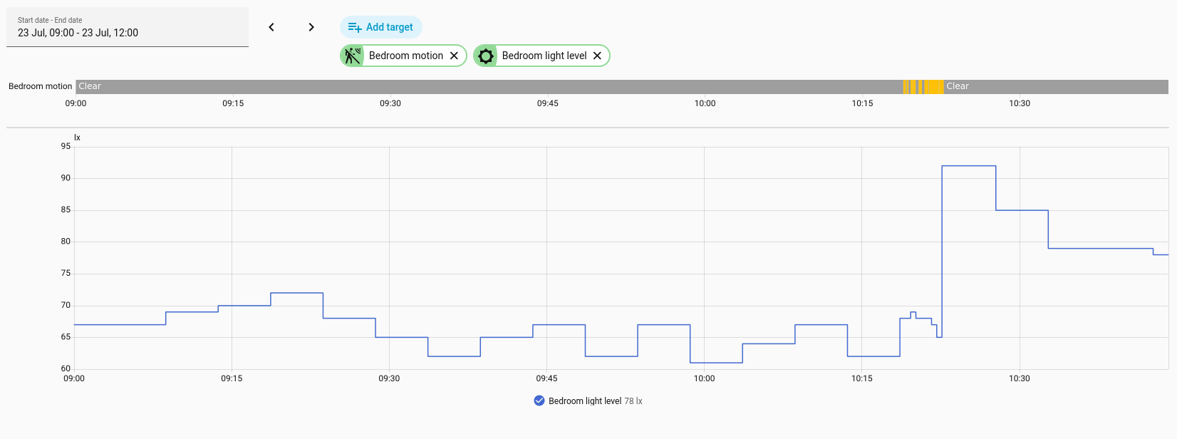

Mine (Philips Hue) seem to report light every five minutes, motion or not… although you do get more reports when motion is detected.
That’s good to know, thanks. The only other motion sensor I know which does this is the FP300 mentioned above. None of the other motion sensors I have do this.
