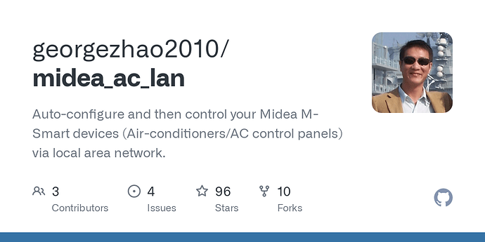

I have been using the ā€œMIDEA AC LANā€ integration from HACS for the last few weeks and I am quite happy with it. It connects to the original USB dongles and has all the functionality it needs. The developer has been very responsive and resolved issues within a day or two.

I have Midea MSOPBU-12HRFN8-QRE3GW Oasis Plus Nordic Hyperinverter air conditioner that has heating range from 16C and up.
It gets recognised with Midea AC LAN (georgezhao2010) and works but i can not set temperature to 16C, it always gives me minimum 17.
Any idea what to tweak ?
I have a similar bug. In Fahrenheit, it’s supposed to go down to 62 and the minimum in HA is 63. I would guess the programmer used a ā€œ>ā€ somewhere where it should have been a ā€œ>=ā€.
Not getting F as low may also be roundup error as the conversion faction per degree is 5/9.
Tried to change constant TEMPERATUE_MIN in custom_components/midea_ac_lan/climate.py to 16.
I can set AC to 16C, AC shows 16. HA will jump back 17C after short while.
If i leave it to 16, HA flaps between 17 and 16 but AC stays 16.
I spent like an hour playing around with that file! Idk why climate.py has an import for ā€œTemperature Fahrenheitā€, but init.py imports Celsius from HA. It seems conversion is done within HA and not the integration, but idk why the integration has both. I tried transitioning that file to farenheight and had all kinds of weird issues. I also tried various decimal numbers for min temperature. 17 C is 62.6 F, which is why it rounds up. Exact 62 F is 16.6667 C, but even using this value for the MIN is problematic it seems. Luckify for the max temp of 86 F, it’s equal to an integer in C, so no rounding errors.
Based on the code for the units, it looks like they communicate in F.
It seems like the contributors to this code are brilliant, so it’s unfortunate they arn’t around to shed some light on it.
