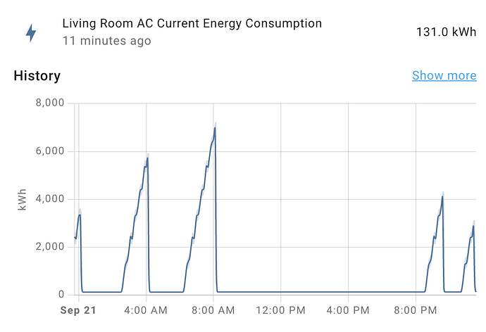

Hi Everyone,
I have a Midea All Easy Pro 18.000 BTU model MSEPC-18HRFN1 / MOX430-18HFN1
This AC unit is integrated with Home Assistant with the Midea integration. I am trying to interpret the energy sensors as they do not make a lot of sense:
The total energy consumption increases and decreases during the day which doesn’t make much sense.
The current energy consumption graph is also somewhat strange. I believe the units are off by 1000, but in addition, I’m not clear why it doesn’t start at 0 on the hour. Can anyone tell me what this is measuring and how I might be able to fix it? I would like to create a sensor that measures instantaneous power and kw/h per day consumed.
Thanks,
Julius
