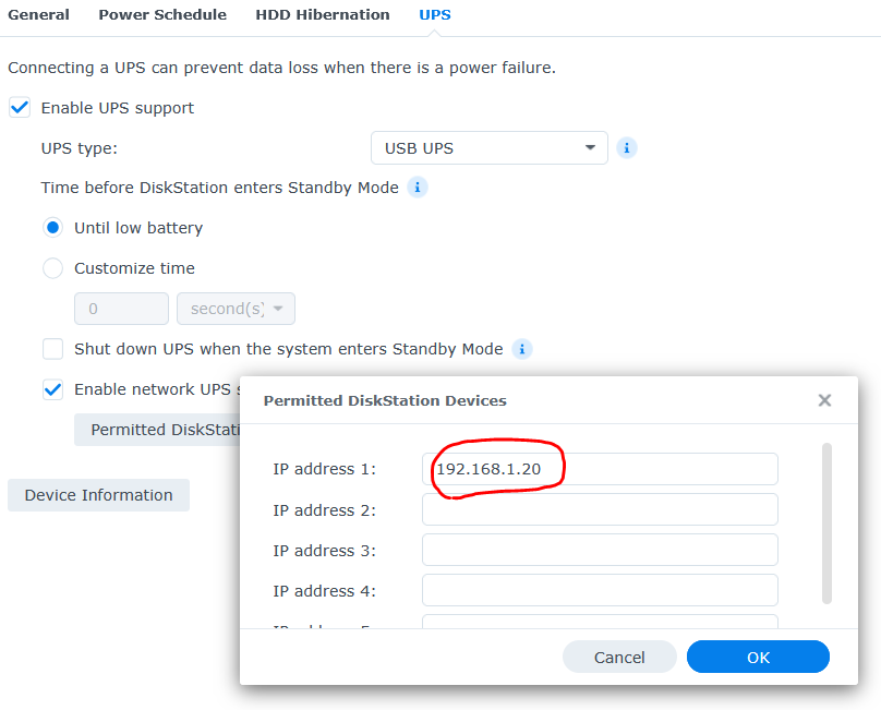

I make use of the in-built functionality of my Synology NAS to act as a UPS server. It has the ability to monitor a UPS via a serial cable connected to a UPS port and also act as a server to make this information available to other devices on the network e.g. HA. The reason for doing it this way is so that the Synology is able to automatically shutdown when the battery low threshold is reached.
This is how the configuration screen looks in the Synology:
The IP address under “Permitted Diskstation Devices” is for my HA instance.

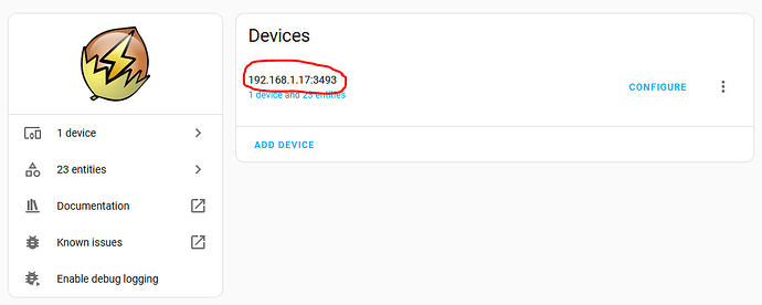

In HA I added the NUT device to poll the Synology for the UPS information, the IP address highlighted is for the Synology:
This then makes the following entities available in HA:
I think you will need to investigate how to get the NUT server software running on your ReadyNAS if possible (sorry but I have no idea about that).
While looking into this I did notice that there is a NUT Integration and also a NUT Add-on although I do not know what the difference is between the two.
So i moved the UPS to my loft lastnight and plugged it into the rear port on the readynas, suprisingly the NAS detected it and knew exactly what it was. This was then passed by it over snmp to HA! So all sorted thanks for the help
