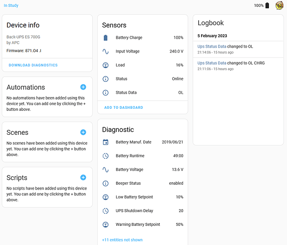

I have a APC ES700 which should be able to backup my server rack for around 45-50mins. The UPS was fairly cheap and the batteries just need changing every 5 years.
The serial cable is connected to a Synology NAS via a 4-port USB extender, I run HA in Virtual Machine Manager and have never had any issues with the USB device changing after a reboot.

What sort of wattage is your setup normally consuming? I am skeptical that a 700VA UPS can power a 200 watt load for 40 minutes. The graph here clearly tells me that you must be running a load of 70 watts or less, which isn’t even a single PC with two rotational hard disks:

It wouldn’t, and he didn’t say it would. The 700VA UPS he uses is at 16% load, indicating he’s pulling about 100W of power, so not far off equivalent time to my 220W on the 1750VA Eaton.

The rack is powering a 4-bay Synology NAS, 24-port switch, Router, and an AP. The UPS is rated 700 VA and it reports a load of 16% which I suppose indicates 112VA.
The APC website actually has a runtime calculator although that needs the power in Watts which I don’t have (guess at some stage I need to stick a clamp meter on it to find out).
Update … I iteratively changed the power in Watts until the capacity hit 16%, this occurred at 66W and gives a runtime of 49 minutes which ties-up. I do however accept that these figures may not indicate real-life usage.
