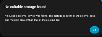

But… How to move back to the eMMC? :joy:
If I use the the option “Move data disk” again, this is what I see:
Backup → System reset or new install → Restore :white_check_mark:
