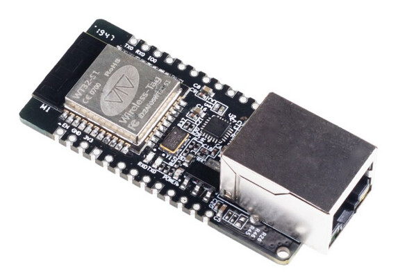

Thanks for the quick response! This solution will involve soldering the DS18b20 on to the NodeMCU correct? And than connect the NodeMCU to an Ethernet cable? And lastly I can easily read the temperature from the NodeMCU into HA?
