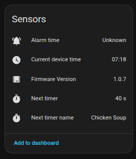

I recently got one of the new 4 mic respeakers and FormatBCE who apparently hosts the YAML for Seeed and it shows timers, timer names, and alarms in the UI. Not sure if he just figured it out as since timers run on the esp32 or voice assistant they don’t show naively in the UI. I can’t speak for alarms or reminders. Seems like you could use sentence automatons to get the status but since I don’t use those 2 functions, I could be way off.
Just search the yaml file for next_timer and next_timer_name as everything is tied together using ID’s, there are two globals, 2 text sensors, and I believe 2 scripts with some things happening in the API part. Should be pretty easy to replicate.
