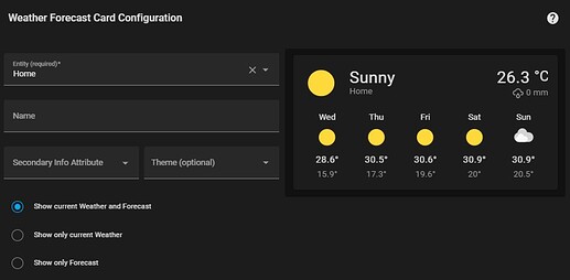

Does anybody else use met office integration for they’re weather ? No matter what I try I can’t get it to display the daily low temperatures, on the default home assistant weather card I get:
Go to developer tools / states and in the entity field type in ‘weather.’ and you will see all your weather. entities listed. If you do this you should see in the attributes column that there is no ‘daily low’ exposed by Metoffice, at least there is not for me anyway!
To combat this and several other issues I use 2 weather integrations, Metoffice as one and the other one is Met.no found here:
I cant remember exactly why I ended up using Met.no (as opposed to any other) but it had the additional info that I wanted and having compared the two I noticed that the Met.no causes zero issues and appears to be more accurate as well.
So with Met.no set as my weather.home you can have this:
I just find met office to me more accurate than met.no, it’s a shame that it doesn’t expose daily lows, what’s frustrating about that is the fact that it’s part of HA core so you would naturally think this would have been part of it(at least the integrations images show daily lows)
I dont use a custom weather card, but wonder if it would be possible to add Met.no and use the low attributes as sensors in the card using templates for example.
