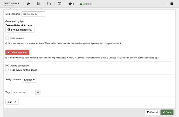

Sure, I’ll see if I can help. It’s been a while since I got it all going now but all my z-way devices are working within HA via mqtt. It’s been very stable.
First up, here are screenshots of the version and config of mqtt in z-way.
Oops, those screenshots are in reverse order sorry.
Anyway, by using the tag of “mqtt” as per the 1st screenshot above.I can add that tag to each device element that I want to partake in mqtt. Like this example for my kitchen lights:
Thats all the configuration required in z-way. Everything else is configured in HA.
