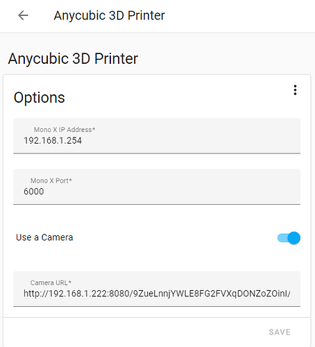

Settings
  • Mono X IP Address - The IP or Hostname of your printer
  • MonoX Port - The port will always be 6000, unless you're running a fake_printer from the uart-wifi pip package to test operations without printing.
  • Camera URL - a URL to an HTML compatible image. Whatever is here will be used as an image source within the UI.
