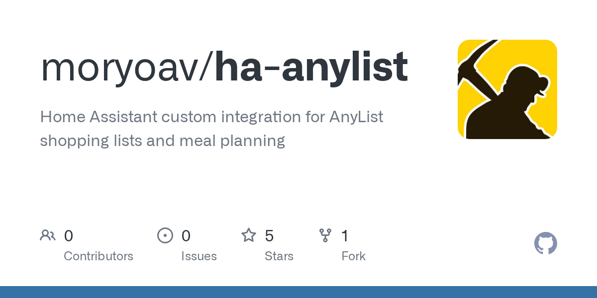

Hi everyone,
I’ve published a new custom integration for AnyList:
GitHub: GitHub - moryoav/ha-anylist: Home Assistant custom integration for AnyList shopping lists and meal planning · GitHub
Latest release: Release v0.4.3 · moryoav/ha-anylist · GitHub
It exposes selected AnyList shopping lists in Home Assistant as standard todo entities, so they work with the normal Home Assistant todo UI, dashboard cards, automations, scripts, and services.

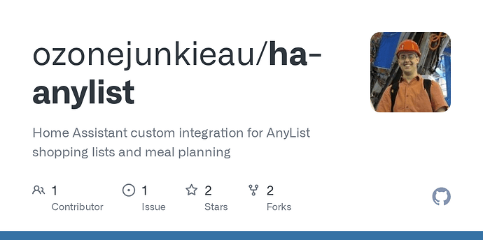

Credit where it’s due: this started from the earlier work by ozonejunkieau/ha-anylist:
That project established the useful idea of exposing AnyList lists as Home Assistant todo entities. This version is now largely/completely rewritten internally. The original integration depended on pyanylist, which itself used a Rust package underneath. That made installation and platform compatibility more fragile, especially in Home Assistant environments.
This integration instead includes a local pure-Python AnyList client and talks to AnyList directly. There is no external AnyList client package and no Rust extension requirement.
